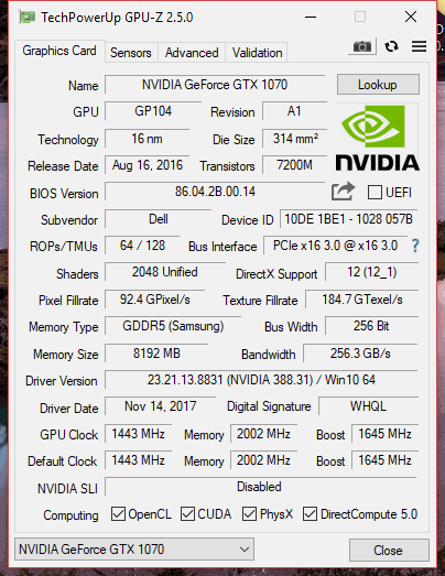

So recently I got my hands on a gtx 1070 but only since recently when I started playing more demanding games, e.g. Wolfenstein 2, Witcher 3, Gta V. I noticed that my fps just randomly drops and goes up again. So I began a quest to look for the cause of this, so I got my hands on furmark, gpu-z and msi afterburner to see what's going on and to my surprise the base clock of the gpu goes down by a lot, it sits around 800-980 while the base clock is located at about 1500, never goes there, according to gpu-z it's a power limit issue but I haven't got the slightest clue how to solve it. :-/
Things I've tried so far, but none worked
- same results with both the 330W and 240W power adapter
- try a different vbios
- set adapter warnings to disabled in the bios
- increasing the core voltage in MSI afterburner
- increasing the core clock in MSI afterburner
- Using the high performance mode in Windows and using maximum performance in the nvidia settings
Hopefully someone can help me.
