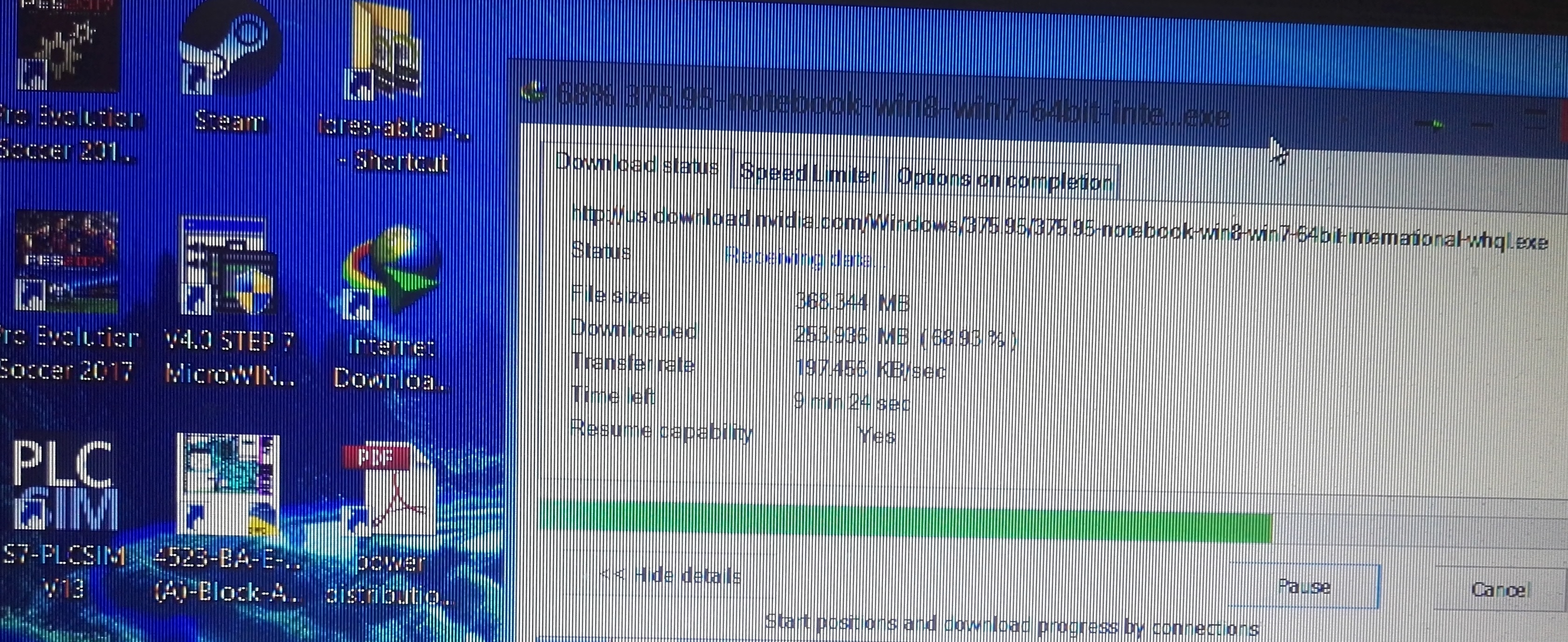

the problem is when i come back to my OEM FHD LCD ... it worked good only on low resolution but at higher resolution it make a lot of distortion and Flickr as shown at pic ( I see text hardly ).

That looks like what happens when you use a FHD display with a cable with only 2LVDS/1eDP lane, either your cable is damaged or the motherboard needs extra components soldered to enable the eDP cable/connector.
Run HWInfo and go to the display tab, take a print screen and post it here.
