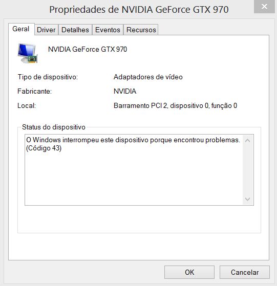

The chainload worked, the laptop started, but then I had an error 43, and I did the steps from this link  that you sent
I had used ddu to uninstall my 540M nvidia driver, then I've downloaded the last GTX970 driver (372.70) and restarted the laptop.
At the start, I am executing the .bat (second option, I guess). The laptop starts with the gtx970 at normal speed, but I got error 43.
At the device manager: "Windows stopped this device because found an error (Cod.43).
OBs: I am connecting the eGPU adapter at the WWAN port of my Dell, not in the place of the wifi card.
The compaction that I used was with endpoint=56.25GB. compacted dGpu to 36 bits  and forced no e to 32.
Soon i'll try other compactions.

Noticed something when I get error 43. If I put in sleep mode and wake back my laptop, go to device manager and " scan for hadware", my dGPU comes back to life and with the (Microsoft Corporation - WDDM v1.2 recognizing it).
I tried some different PCI compactions, some got me back to error 12, others to error 43. Still stuck in error 43.

The error 43 maybe is happening because of having the mobile NVidia and desktop NVidia drivers loaded simultaneously. Where can I start to look to fix it?
I made the "save Dump file" thing, exported via the Rw everything, and then loaded the Dump file. Yet returned to error 43. (I have the images if necessary. I didn't attached them here to try not to make this post even bigger)
