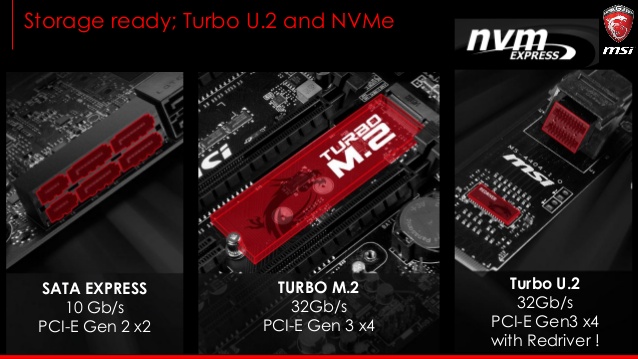

Anathema666 Posted October 31, 2015 Share Posted October 31, 2015 I bought a MSI GT 72 - 6QD Notebook. It has the new M.2 PCI-E 3.0 x4 slot with 32GB/s. (the picture is from a desktop mainboard) Any adapters out there to use it? Anyone already tried it? Link to comment Share on other sites More sharing options...
Tech Inferno Fan Posted October 31, 2015 Share Posted October 31, 2015 I bought a MSI GT 72 - 6QD Notebook. It has the new M.2 PCI-E 3.0 x4 slot with 32GB/s. [ATTACH=CONFIG]16415[/ATTACH] (the picture is from a desktop mainboard)Any adapters out there to use it? Anyone already tried it?None as yet and likely the PCIe3 8Ghz signal will be problematic without use of specialist cables and Redriver chips.If wanting to eGPU at x4 3.0 suggest get a TB3 equipped notebook. A comprehensive list being maintained by zacsaturday at http://forum.techinferno.com/diy-e-gpu-projects/10147-intel-unveils-thunderbolt-3-0-mentions-external-graphics-skylake-q4-2015-a-9.html#post147483 Link to comment Share on other sites More sharing options...
Anathema666 Posted October 31, 2015 Share Posted October 31, 2015 It also has a SuperPort connection, which is a rebranded TB3. So its seems like waiting for TB3 devices/boxes is the only way for now, 1 Link to comment Share on other sites More sharing options...
