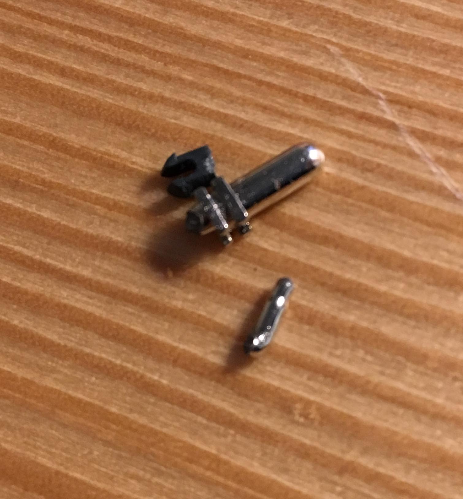

Hi, can help me T-T
Today, I received every component I bought from eBay and tried to set up my eGPU. I intended to power the Akitio and graphic card using the Dell DA-2. However, I didn't realize the barrel plug was not compatible and I pushed it so hard that the central part of the connector broke as the photo showing. Is there another way to power my Akitio?
Edited by 1366921
