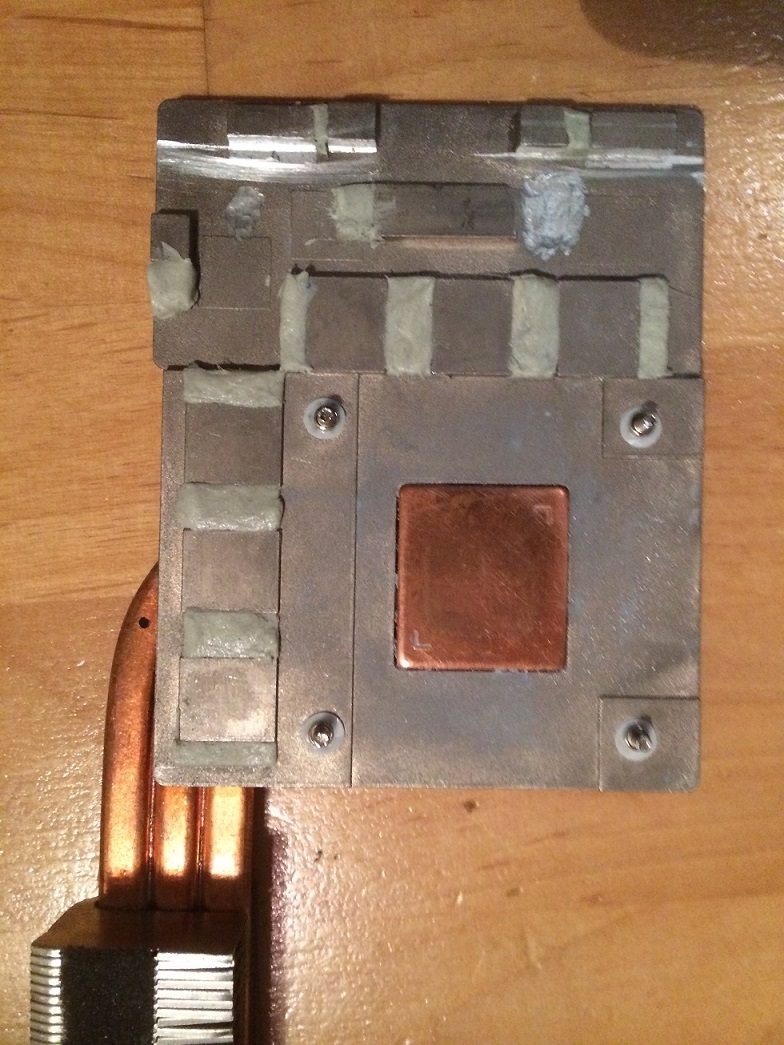

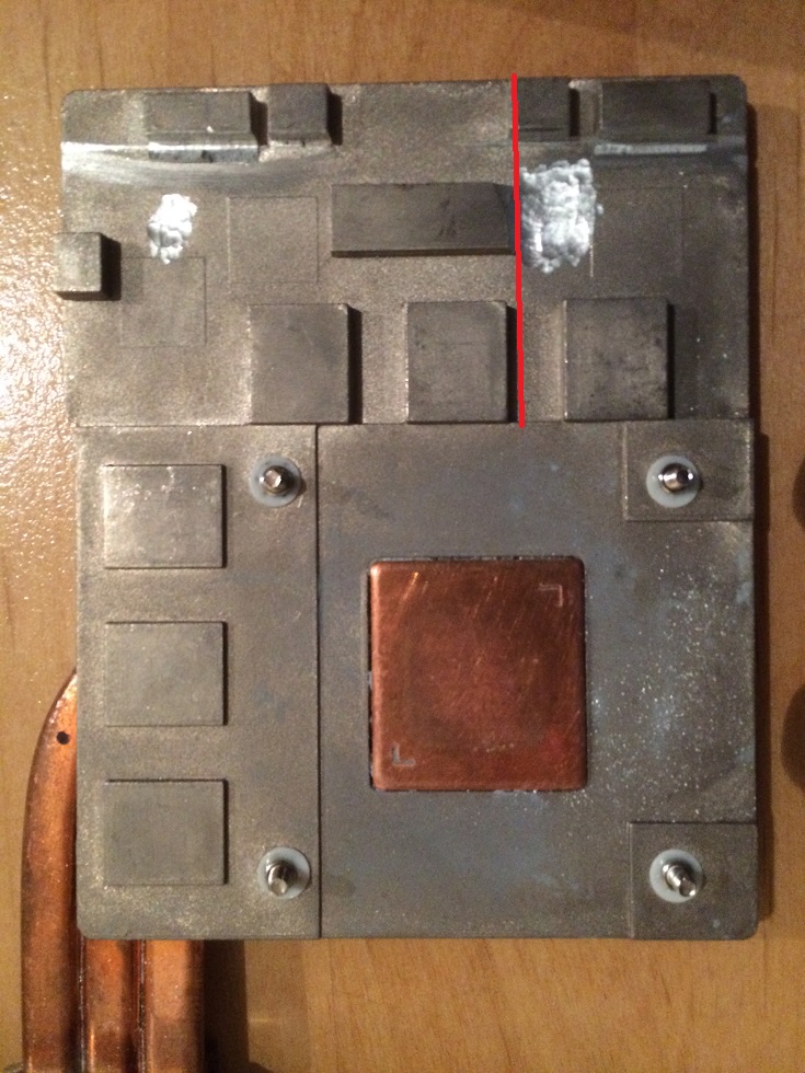

PixelRaide Posted April 27, 2017 Author Share Posted April 27, 2017 I'm reviving this old thread to give eventual GX660 owners an update about what they can expect from their computer. i finally found a heatsink with the CPU bridge for a decent price (from ebay, ordered from a seller in the USA, it was cheaper than what i could find in germany. I'm living in France btw). At the end of the week i will finally install the K4100m i bought in 2016 (yes, it is a long term project). I will come back here and give my impressions and some numbers. Hope i will not be disappointed with the performance that the 920XM and the overclocked K4100M can provide. This is the last update i'm planning to do for my precious GX660 that served me well for 6 years now. I'm still amazed by this old laptop and can't imagine selling it even if i have a pretty decent gaming RIG. Hail to the GX660 ! Quote Link to comment Share on other sites More sharing options...

PixelRaide Posted April 29, 2017 Author Share Posted April 29, 2017 (edited) Hi Bloetschkopf ! Installed the new card and it doesn't pass the BIOS screen and i can't access the BIOS's settings anymore. Any idea ? If i wait the screen just go black and there nothing happen after that. I reseted my windows and uninstalled the drivers of my 5870m EDIT : Maybe it is linked to a bad vbios ? When i put back my 5870m it's working again... Need to flash your vbios but i can't access to the boot menu to boot on the usb drive... Edited April 29, 2017 by PixelRaide i'm looking for a solution for 4 hours now Quote Link to comment Share on other sites More sharing options...

PixelRaide Posted May 2, 2017 Author Share Posted May 2, 2017 (edited) I MADE IT ! Successfully flashed the vBios by myself using a Win98 DOS instead of FreeDos ! Reinstalling the whole Windows 10 right now, coming back soon to give you updates ! Hell yeah ! EDIT : The vbios you provided me seems to be too high, temps goes quickly to 93°C in 3Dmark (firestrike) and the core clock is throttling. The kepler heatsink should provide sufficient cooling capabilities for your vbios no ? i used some Arctic Silver 5 thermal paste i put some new thermal pads on the components, it should be enough. BTW thanks again for your vBios, really appreciated EDIT 2 : Maybe the heatsink isn't properly fitting on the chip, the thermal pads that i used are larger than the original ones. They are soft and i though that the pressure of the heatsink could be enough to flat them well. Edited May 2, 2017 by PixelRaide other question asked Quote Link to comment Share on other sites More sharing options...
aconix Posted May 3, 2017 Share Posted May 3, 2017 I MADE IT ! Successfully flashed the vBios by myself using a Win98 DOS instead of FreeDos ! Reinstalling the whole Windows 10 right now, coming back soon to give you updates ! Hell yeah ! EDIT : The vbios you provided me seems to be too high, temps goes quickly to 93°C in 3Dmark (firestrike) and the core clock is throttling. The kepler heatsink should provide sufficient cooling capabilities for your vbios no ? i used some Arctic Silver 5 thermal paste i put some new thermal pads on the components, it should be enough. BTW thanks again for your vBios, really appreciated [emoji6] EDIT 2 : Maybe the heatsink isn't properly fitting on the chip, the thermal pads that i used are larger than the original ones. They are soft and i though that the pressure of the heatsink could be enough to flat them well.Hello guys, Did you find a solution for the temperature? I have an MSI Gx683dxr with a gtx570m, anyone know if the GTX680m 2GB from an alienware will work? My cousin has one and he can send me for free. Thank you, Enviado do meu SM-N9005 através de Tapatalk Quote Link to comment Share on other sites More sharing options...
PixelRaide Posted May 3, 2017 Author Share Posted May 3, 2017 Hello, I'm using my laptop for my studies right now so i'm only using Word and Chrome, don't have time to play so i have no time to investigate on the temps. The Vbios that Bloetschkopf gave me is overclocked, if i downclock the frequencies to their initial state the temps are acceptable (~85°C). In the future i certainly will take a closer look on the heatsink, the thermal paste etc. to exploite the full OC potential of the K4100M. If you can get it for free and if you have a heatsink that fit (don't know your laptop and don't have time to search sorry !) you should catch this opportunity ! Hope you will not struggle too much with the vBios as i did as it's coming from an Alienware. At least you know that the HP USB tool and the Win98 DOS can help you Good luck ! 1 Quote Link to comment Share on other sites More sharing options...
Bloetschkopf Posted May 3, 2017 Share Posted May 3, 2017 If the temperature goes to 93° something is wrong with Your cooler. I had used more than one Keplercard in this Barebone,also with OC the Temperature goes never to 93° Only the GTX 880M make this Temperature in Full lLoad. 824MHz is nothing for this Card,this is the normal Coreclock from the GTX 780M. Quote Link to comment Share on other sites More sharing options...
PixelRaide Posted May 3, 2017 Author Share Posted May 3, 2017 13 minutes ago, Bloetschkopf said: If the temperature goes to 93° something is wrong with Your cooler. I had used more than one Keplercard in this Barebone,also with OC the Temperature goes never to 93° Only the GTX 880M make this Temperature in Full lLoad. 824MHz is nothing for this Card,this is the normal Coreclock from the GTX 780M. I will look at it one of this days, i know that those temps aren't normal. Like i told you before, i think that the thermal pads i used dont let the heatsink fit properly on the chip. As i'm using the computer, i hope that the heat and the pressure will do their job to flat them ! will come back here anytime i have some updates about that ! For now i have an other issue to solve : The laptop isn't working when using the battery : If it's plugged, perfect. If i unplug it, even with the battery in it, immediat shutdown. Can't starts it if unplugged. In Windows it tells me that the battery is charging and the LED of the touchpad is orange (or blue). Wierd ! Quote Link to comment Share on other sites More sharing options...
