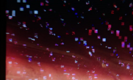

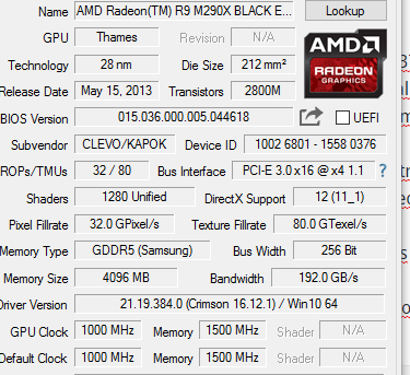

  4. hey there, first of all, sorry for my bad english i have a problem with one of my gpu´s in my p370sm. i had installed the relive drivers from amd, things went fine, after some gaming i had windows updates installed. suddenly i ve got a blackscreen on boot and no POST. i bought a new vbios with the stock bios programmed, the card did a post, but i have 2 problems: in the bios the gpu is shown as 4x pcie link, ive tried both slots, and both of them shows the same pcie 4x link speed. on windows its the same issue, pcie 4x link speed. i have artifacts in 3dmark, and doom. guild wars 2 runs normally. ive found some pictures on internet showing those artifacts like i ve got and explain them as "bus artifacts". how do i fix it? or must i replace the hole mxm card?

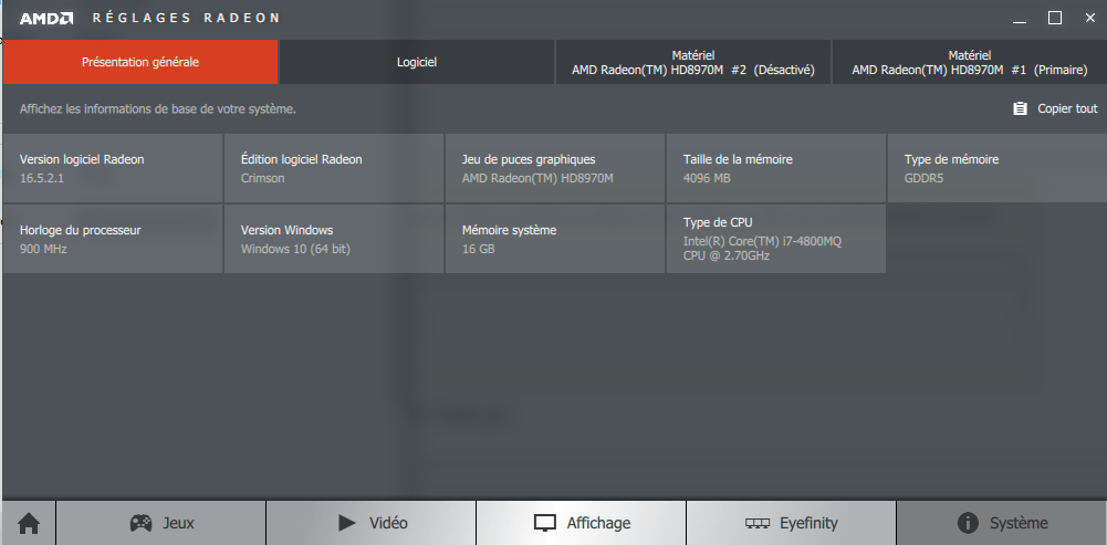

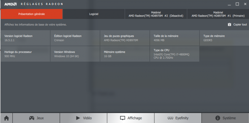

  6. Hello, I come to you because it is very rare to find topic concerning crossfire notebook. I have bought 2 years ago a p370sm with 2 8970m 4GB paired in crossfire. 1 year ago , one of the two graphic card stopped to work. I've tried to swap the graphic card from their slot and I concluded that one of the two gpu was dead. I stayed for a long time with only one GPU on the primary slot, and 2 weeks ago , i ordered a copy of my card on Aliexpress: http://www.aliexpress.com/item/HD8970M-HD-8970M-R9-290X-4GB-GDDR5-MXM-for-CLEVO-P570WM-P370EM-P37xSM-P37xSMA-P150EM-P150SM/1978000913.html The card was recognized by my laptop and It showed two cards 8970m in the Device Manager. On CCC , the two cards were recognized but the second was "(desactivated"). I tried to reinstall catalyst but the problem is still here , i can't enable crossfire on the Radeon menu. i've made a gpu-z test and i've seen that the version of the two GPU were not the same. Moreover the bus version is different between the two cards. The responsible can possibly be the wire between the gpus ,it stayed in a drawer for 1 year. I've heard that @Prema is very qualified in Clevo gpus. Thank you for your future response. Have a good day, (All apologies for my english , I'm french)
