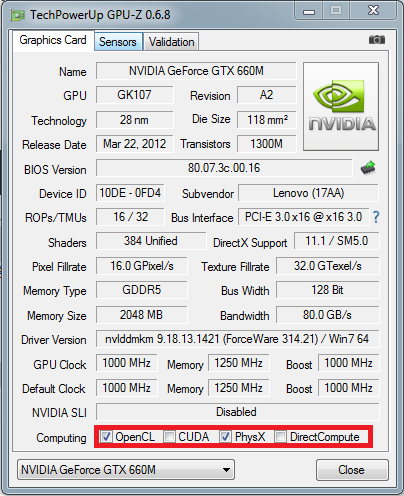

  6. How is that your GPU-Z shows CUDA and DirectCompute checked and PhysX unchecked? Cause mine shows opposite
  7. I am using Nvidia Inspector

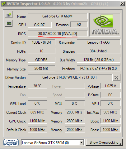

  9. And why is Nvidia Inspector showing [iNVALID] at BIOS.
  10. Ok, I get it now :-). And I want to thank you, because it works great (I'm using v2.07).
