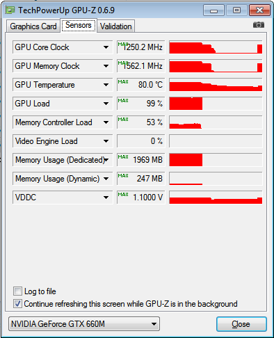

1300 mhz gpu and 3125 mhz mem.. but i'm running gpu at 1250 mhz and mem at 3125 mhz for maximum stability... just want a bit more voltage, so that these clocks are even stable for future it would be nice, if these clocks are set in bios i know that the temps will increase... but I still have the option to re-apply the thermal-paste big thanks for your help!
just a short update from my side :3 wish i could change the clocks in the bios to these ones and a VDDC of max 1,115 V or 1,125 V... crysis 2 runs great, even with Maldo HD-Textures v4.0 Final... never goes under 40 fps... i made the screenshot of gpu-z after two hours playing crysis 2 with this mod

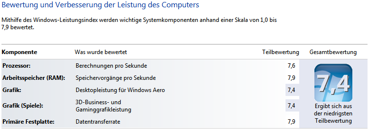

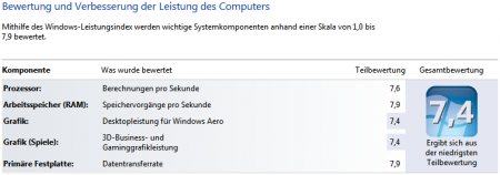

...some people can deal more with the windows 7 experience index.. so here it is, of my Y580, tuned (probably) to maximum. nice machine -

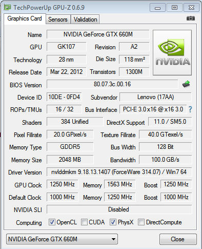

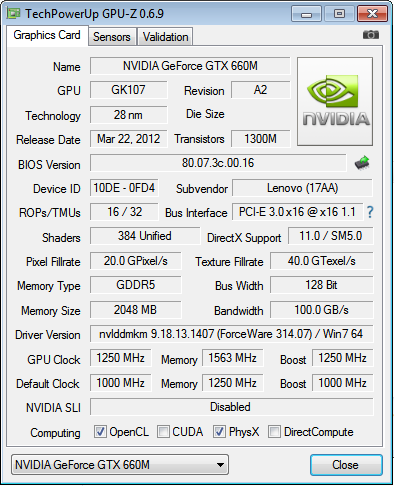

ok, i tried it! i chose a higher clock, but it didn't changed anything.. nevertheless it's a great bios. the gtx 660m runs now with 1250mhz gpu and 3125/~1563mhz mem... a bandwidth of 100 gb/s runs great.. max temperatures are 85°C after 3 hours battlefield 3 it seems like my Y580 have some great thermal paste.. because i didn't change anything on the laptop.. this result is even without a coolingpad under the laptop.. but i will buy one soon. 1250mhz gpu and 3125mhz mem are really recommendable settings for the gtx 660m!
