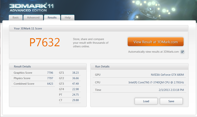

  4. Well I just updated to the newest MSI BIOS right from the GT70 0NE page using a DOS driver and ran up some benches again! and whadaya know MUCH BETTER! especially in the CPU area take a look: old BIOS: NVIDIA GeForce GTX 680M video card benchmark result - Intel Core i7-3740QM Processor,Micro-Star International Co., Ltd. MS-1762 score: P7632 3DMarks new BIOS: NVIDIA GeForce GTX 680M video card benchmark result - Intel Core i7-3740QM Processor,Micro-Star International Co., Ltd. MS-1762 score: P7718 3DMarks the overall score isn't THAT much higher but it is significant as the GPU score didn't change much however there was a gain of a few fps here and there. the biggest difference though was the CPU score which with the new BIOS leaped up over 100 points! thanks @buluunee

  9. I finally got set up got all the right BIOS and VBIOS installed and got the new nvidia beta driver and did a 3dmark 11 bench! I was running at 1006mhz core and 2399mhz memory just to clarify the lies on the 3dmark result page NVIDIA GeForce GTX 680M video card benchmark result - Intel Core i7-3740QM Processor,Micro-Star International Co., Ltd. MS-1762 score: P7632 3DMarks
