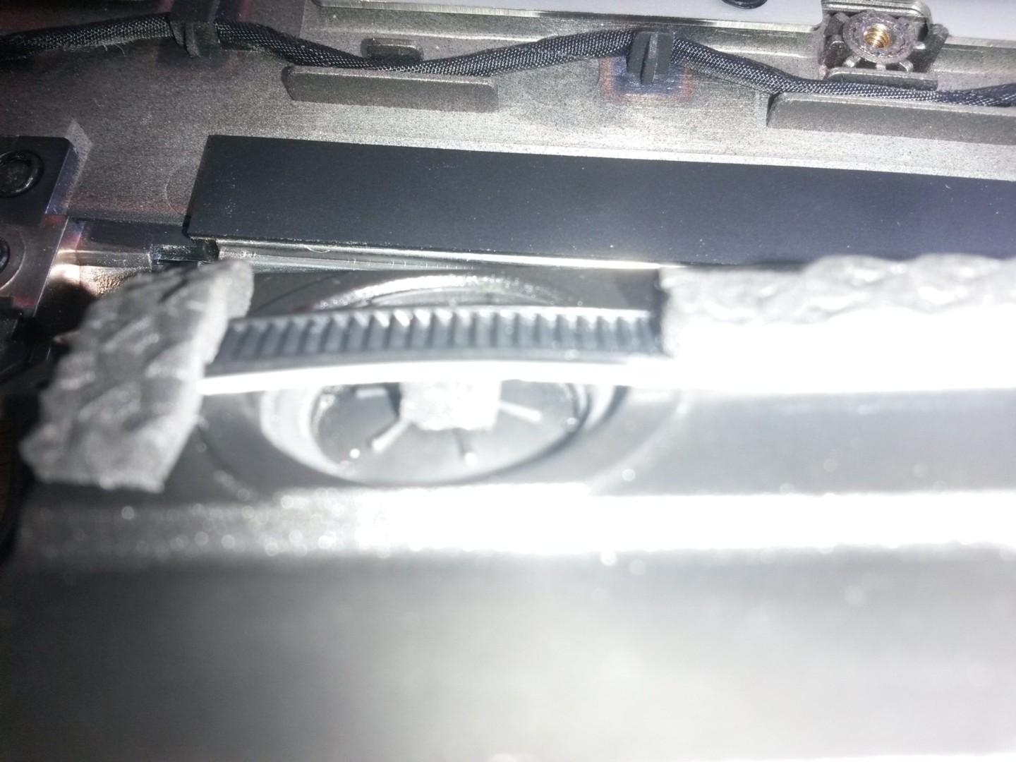

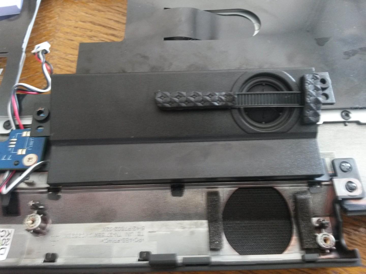

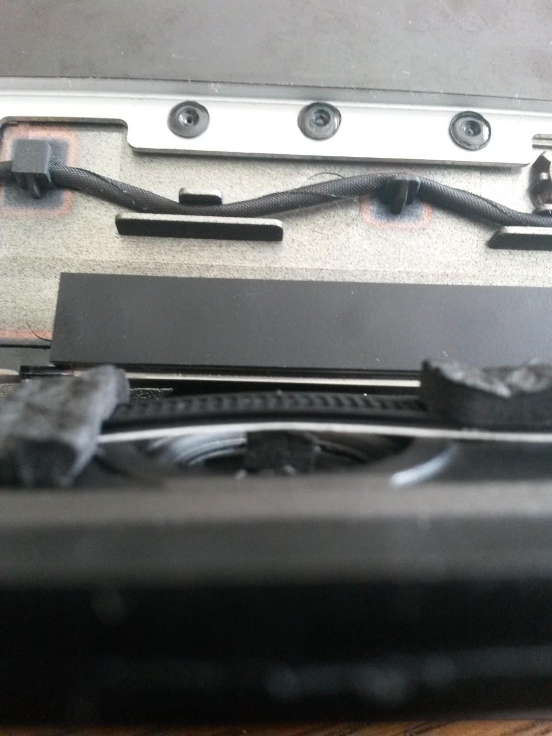

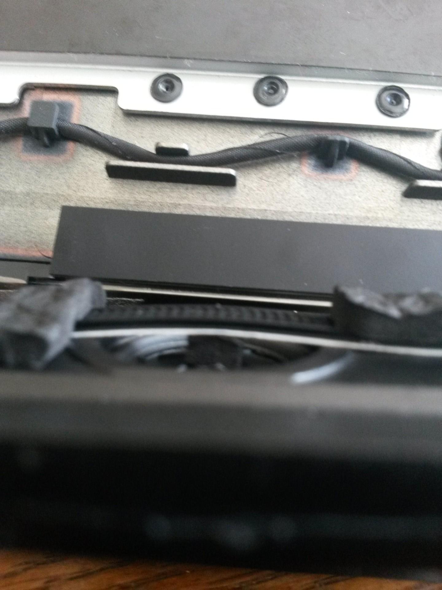

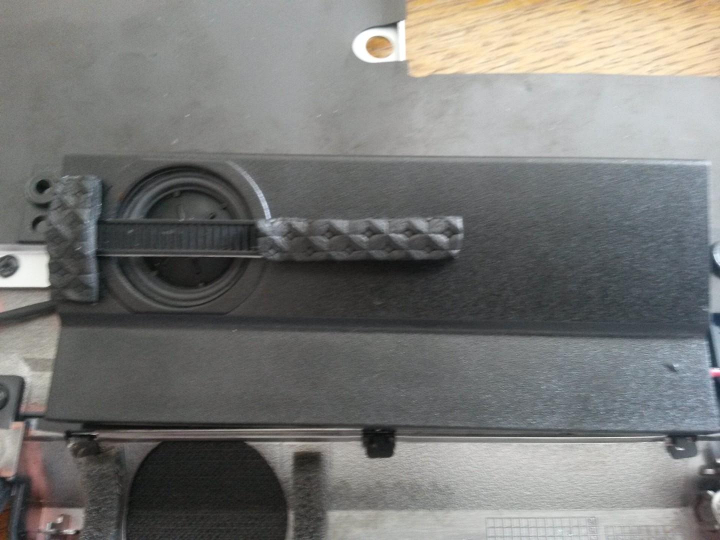

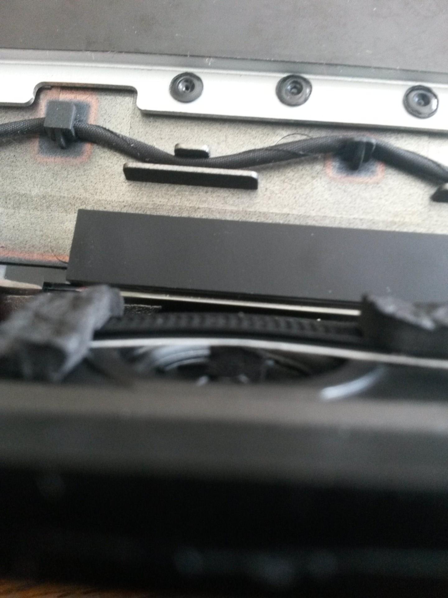

After 1 mounth using an clevo p751dm the speakers begun to crack . . . after disamble the computer was show that the Speakers looks fine but that the build in with direct contact to the heatspreaders of coolingsystem from CPU & GPU in the Chasis. The Reason to do think about a Hardware Isue was that HeatSet output done Sound Allright & mybe the test with Speackers they Chill easy around in they Ready to be Collection as Joker or Black8. Long Talk short Sin the construct and materials wrong . Materials: Foam Rubber Pads / Double Site Adhessive / Cable Fixer - the Trick is harm/prevent the Speaker membran moving to fast Maybe after the fix Speakers a little byte silencer. Hole in speakercase can do also HotFix because hot air-flow and acoustic-system. Maybe lower electrical Power thats given to Speakers with an Resistant Material can do an DeCracking also for other Vendors. The fix below in Pictures / all parts sticky together also membran Doesn´t used Glue because it can Damage the MembranMaterials . . . all Sticky´s by TapesGlue .
