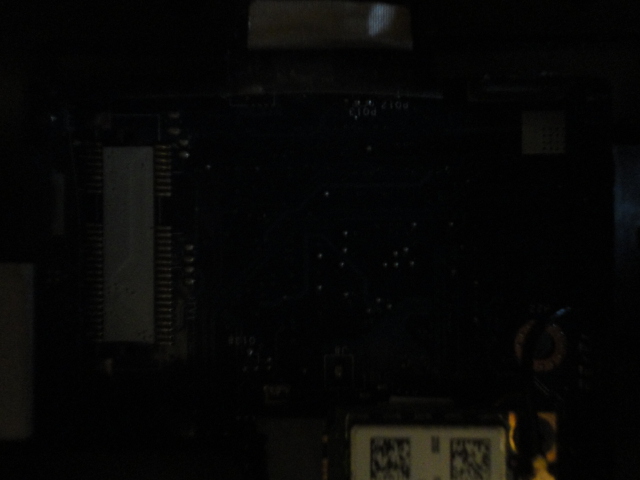

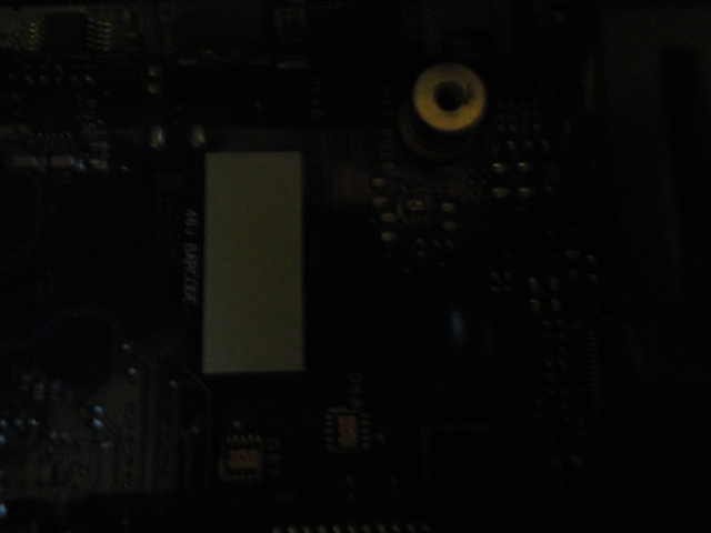

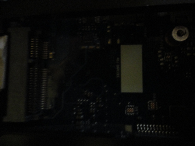

  2. From the looks of things, it looks like there should have been an additional Mini PCIE card edge slot attached to the Y500 motherboard for a Mini PCIE TV Tuner. There is even a driver for a TV Tuner for the Y500 on the Lenovo website: http://support.lenovo.com/us/en/downloads/ds032571 I found an alternative card edge to the original card edge that is attached to the Y500 motherboards: https://www.digikey.com/product-detail/en/jae-electronics/MM60-52B1-E1-R650/670-2275-2-ND/2071034 This particular card edge being sold at DigiKey has a different height from the one on the LinkConn website. The card edge on DigiKey is 5.9mm in height, while the one on LinkConn is 6.75mm in height. I believe all the other specifications are the same. It was the closest available match I could find. We would have to solder the card edge to the motherboard somehow. Then, we would need a nut for screwing in a Phillips screw and a rubber stand (or whatever you call it) to keep a full length Mini-PCIE card in place while it is connected to the card edge. Then we should have a working, extra Mini-PCIE slot on the Y500 motherboard for Mini-PCIE cards. I suspect if the card edge was to be soldered correctly in the particular area that I have shown in the pictures along with the nut and the rubber stand, and if we were to place any of the following Mini-PCIE TV Tuners into the extra Mini-PCIE slot and install the TV Tuner driver from the Lenovo website, we would have a fully working TV Tuner on the Lenovo Ideapad Y500: 16 TV Tuner Module, DMB-T, Geniatech, MM7000DMBT TV TUNER 11011329 * 16 TV Tuner Module, DMB-T, Yuan, MC163 TV TUNER HYBRID MINICAR 11011447 * 16 TV Tuner Module, DVB-T, Avermedia, AM H339 DVBT Hybrid TV Turner MiniCard 101500048 * 16 TV Tuner Module, ATSC, Avermedia, AM H339 ATSC Hybrid TV Turner MiniCard 101500047 * 16 TV Tuner Module, DVB-T/ATSC, Yuan, MC907 TV TUNER HYBRID MINICAR 11013387 *

  13. So I took a look at the motherboard of my Y500 laptop, and I discovered something very interesting: There seems to be an area on the Y500 motherboard where an extra Mini PCIE x1 could have been, and it looks like this might be true of other IdeaPad motherboards as well. I identified the card edge that was on my laptop's motherboard, and the company than made it. I tried to contact the company, but my messages didn't seem to go through. This is what I tried to ask them: So the question is: Could you install another Mini PCIE x1 to this laptop and use another Mini PCIe device with it (i.e. an mSata hard drive, another Wi-Fi card, etc.) ?
