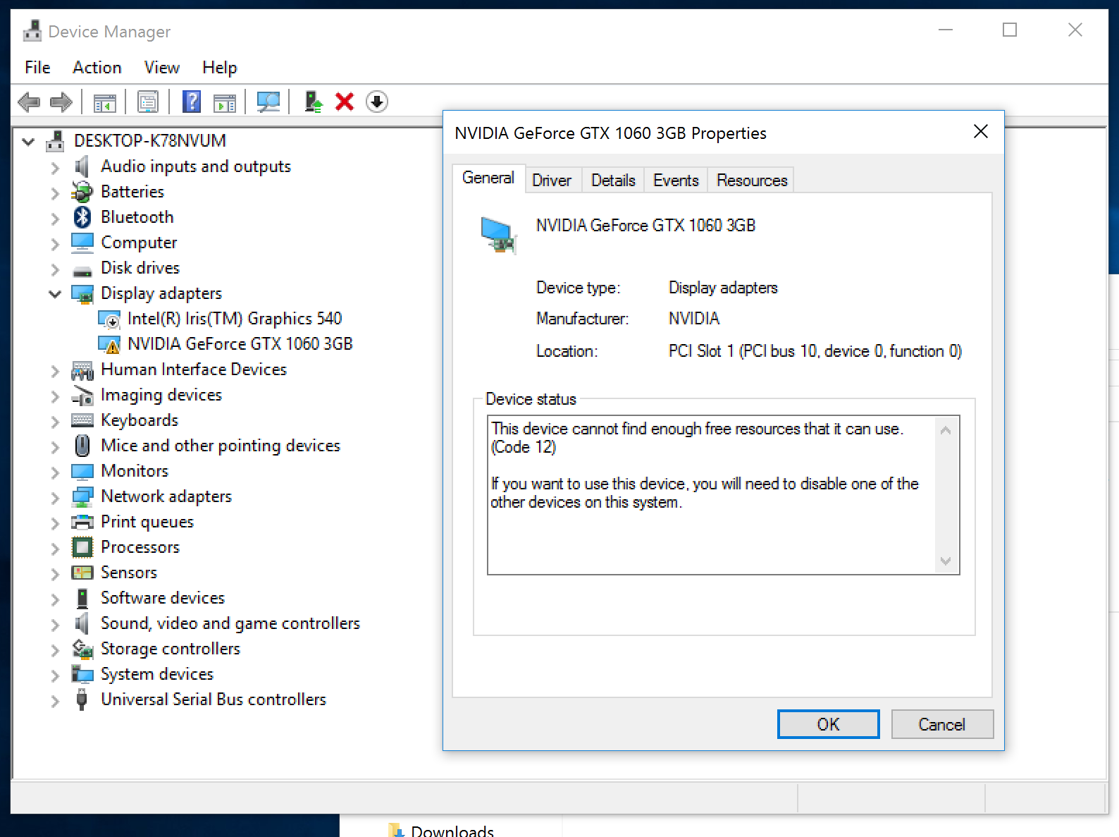

  4. Morning Device manager started off with the usual 'Microsoft Basic Display Adapter' message. Waited a bit for windows to find its drivers, and restarted when prompted. No luck initiating it with the default drivers. After boot up, I've downloaded the latest Nvidia driver for the card and did a 'clean install'. All drivers installed with no issues. It's the non touch bar 13''. The only thing I didn't turn off was the power supply for the Akitio (550w PSU with the barrel plug mod). - will give that a go now. As I've said, with the same procedure, I had my previous 13'' 2015 retina working. Also, under OSX, the card gets recognisez but with no luck of finding drivers (no pascal web drivers at the moment). I'm thinking that the TB3 to TB2 may have something to do with this? Side note - Win 10 was installed via the new bootcamp method, where a usb is not needed anymore. Thanks for your time
  5. Top of the evening. Just had a go at this with a 13'' 2016, akitio thunder2/TB3 adapter (from apple), an external PSU/barrel plug mod and a 1060 EVGA 3Gb. Managed to install the drivers in Win 10, but can't get it initialised correctly. I get some activity on the external screen, but in the form of some artefacts and windows freezing. Tried all the variations of plugging it in at certain times etc, as I had the box working on a 13'' 2015 with a Zotac 1060, therefore have the experience. Anyone in this situation? Thanks
  6. Sorry for the late reply. How did you install Win? I've done mine using a win 10 stick and not using bootcamp. Not sure if this makes any difference. I got it working by - restart your laptop, when the chime comes on, press option to select the startup drive, and right after, plug in the box. Wait for a few seconds, then select the windows partition. It gets recognised about 1 in 10 times. If you reboot more than twice and get the infinite loop, it will go into auto repair. Unplug the box, restart, wait for the auto repair to do its thing, then try again. Either this way, or plugging it in right at the first 'wheel spin'. Got it working superbly stable, but with an external PSU and the barrel plug mod. Now I'm trying to get my head around a 2016 13'', the same box, but with a EVGA card..
