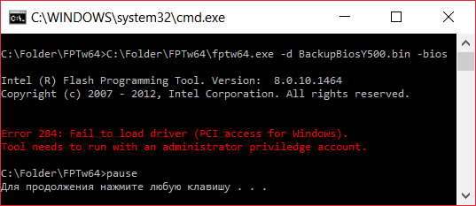

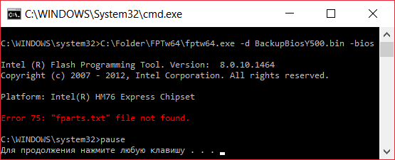

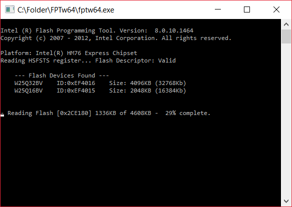

Another error: Now when i am trying to make backup of my BIOS: (on simple double click): (Run as administrator) But as your may guess - it's in the same folder. I am also added in *.bat file full address. Now it's look's like so: SOLVED: Right click on fptw64.exe and go to Properties => General Tab (press Unlock button) Then go to Compatibility Tab and check box Run as Administrator After that your are able to just double click on backup.bat
