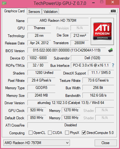

Here's a collection of logs ran at stock settings with throttlestop on, 920/1270 throttlestop on and 920/1270 throttlestop off. Bios as can be seen in the attachment. (from one of your postings in the atiflash thread). I don't understand the need to run throttlestop, as this was one of the reason I switched to this M6600 as I thought it could take the power hungry components (as opposed to my forger msi gt683). 9201270 ts off.zip 9201270 ts on.zip stock TS on.zip
Gonna try just that. Be right back. LE: Trying several vbios version I found across the board. Apparently with 022 0.975v works best so far (no throttle or random downclocking). Trying my luck with 022 1050v I found in some other thread. With 017 version , different voltages, gpu-z would still report 0.975 max voltage. With 022 it's reporting 1.05v. I am thinking as long as temperatures are in range of 80-85 everything would be ok for the card? (max temps recorded in 3dm11 so far was 73 degrees anyway).

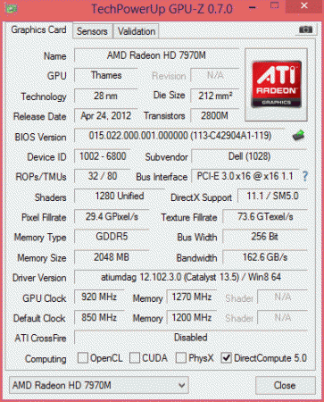

The clocks do change, the issue is that I am getting absolutely no benefit in benchmarks/fps ingame. That screenshot is just to show the stock bios version. I'm not saying that I want to run it at max sliders, I am just trying to get to the bottom of why the OC has no effect on ingame fps. Thing is, If I run 3dm11 at stock clocks and everything I get roughly 6.3k points. With the slight OC to 900/1400 I should get a somewhat increase in scores, but that is not what happens. The scores either stay the same or can even go down. Same configuration on my former laptop and OC to 900/1400 I would reach in the vicinity of 6.9k.

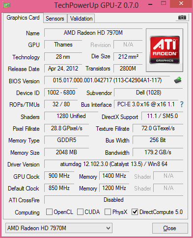

Offtopic : I can post now Ontopic : I'm running a dell 7970m pulled from an M18x in my current m6600. All if fine, the card was plug and play with no issue to date. However, the benchmark scores are a tad lower than expected. The more I oc the card (via profiles.xml) the lower the scores go. I have tried OV via xml trick also and no apparent improvement in scores. With my current setup I cannot break ~6.5k 3dm11. In my older msi gt683 with an exact same setup I could easily reach 7.1 7.2k 3dm11. I am running 017 bios version (as can be seen in screenshot) and running stock voltage of 0.975v. When ov-ing via xml to 1.05v I can take sliders in CCC to max and the card still be stable, but the damn scores in 3dm11 stay the same or even worse, go down a notch. I have ran furmark (at stock clocks and voltage) and there is absolutely no throttling. I have tried furmark also on my current setup 900/1400 @ 0.975v and no throttling. Would a bios flash help me out? And if yes, what version should I be looking for? Just to mention, in full load the cpu never goes past 91-92 degrees and after 2-3h of bf3 I have never seen the gpu go over 80 degrees. And a second mention, I get random reboots and system freezes (that I cannot explain at all) both at modified and stock clocks. - I try to think these are because of drivers.
