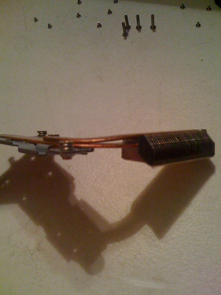

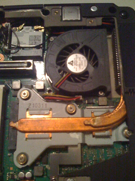

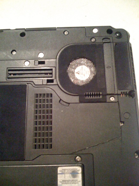

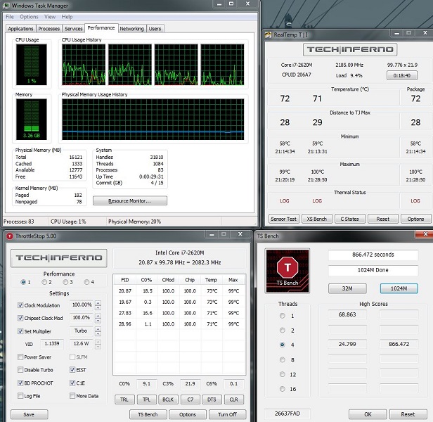

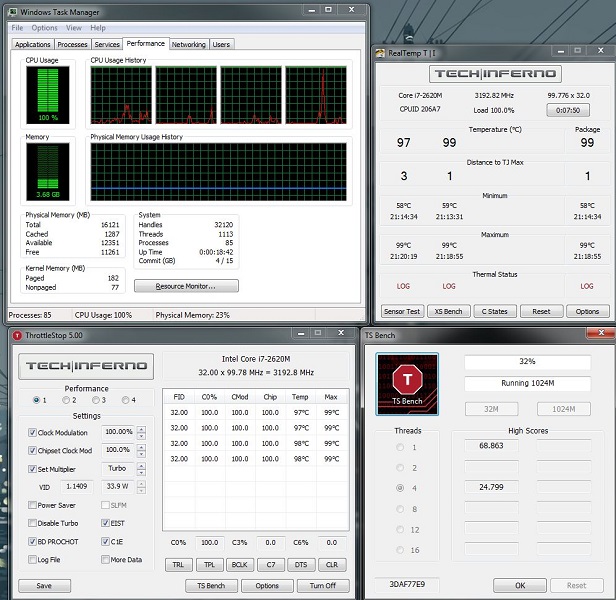

  2. UPDATE! (and partial success story). I got some washers to put between the screw head and the heatsink (there are springs on the heatsink posts themselves so this pretty much just compressed the springs more). I made a offset plate for the fan. Now the fan sits directly on the heatsink with no gap. Sitting at ~45 idle. I ran the ThrottleStop benchmark on 4-threads 1024M. I went from a completion time of over 800 seconds to ~650 seconds. CPU did not throttle at all (according to RealTemp). No longer having 100C temps under load. It still gets into the 90s, but that is only under a full load. I haven't tried the fan mod yet. Yay modding! atn

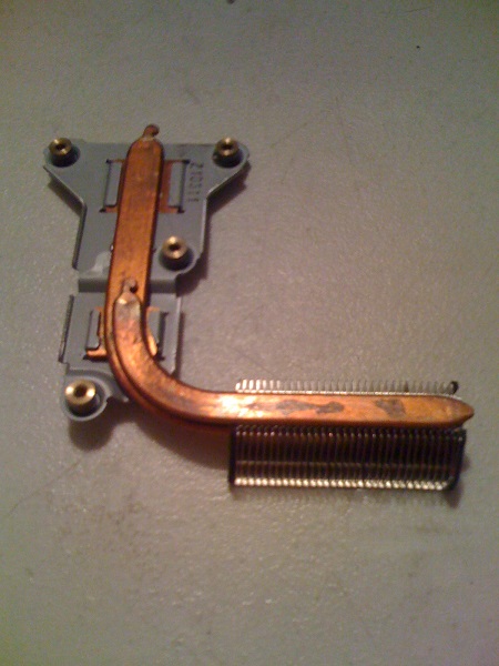

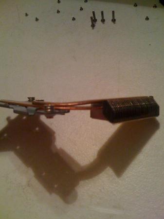

  8. If the heatpipe is adequate then, I would guess it is either the fan that doesn't ramp up too much to push air through, or (and this is probably the main reason), the fins on the radiator are kind of 'loose', it is quite easy to slide them around. So the fins are probably making very poor contact with the heatpipe, and I have no idea how to fix this; apart from swapping the heatpipe+fins and replacing it with one from a different laptop (if I can find one similar). I work at a small computer repair shop so we have a ton of these in a box. I try to add some washers too. I saw on on comments in another thread you used the Coollaboratory Liquid Ultra, would you suggest this? (I'm using Arctic Silver 5 atm). Although it appears something more serious than the thermal paste is the issue here. One pretty obvious issue (I think) is the edge of where the CPU makes contact with the heatsink is right on the edge of the copper and steel of the heatsink. I can see a little mark where the CPU sits. There is at most a 1mm space from the edge of CPU to the edge of the steel/copper of the heatsink. I would take a picture, but it wouldn't show up. I try some more modifications tomorrow. Thanks again, atn
  9. Sadly I do not have room to do that, best I can do is put another copper heatpipe on top of my current one, that will be a fun weekend project... I would solder it though. Can this be done the same way like copper pipes in home plumbing? Use a propane or MAPP gas torch, heat the pipe, put solder on the joint, remove heat? Hmm... Maybe if I got a heatsink from another laptop and just put it on the current mount, I can desolder the puny one that is on here now and put on a much larger one. Thoughts? @Khenglish I will give it a whirl and report back. Maybe if I find a suitable heatsink I wont need any form of spacer, that would be superb. (I might even be able to suitably support a quad-core!)

  14. I'm guessing when you say 'VGA' you mean 'eGPU.' Normally (at least in my case), when the eGPU fan is running on max, that is the sign of some error. Hearing about your PSU, I would suggest trying a different one with a 24-pin connector and with a little higher wattage just to be sure. Mainly just getting the problem isolated down to being just a computer issue. If the adapter is working, eGPU isn't fried, PSU supplying correct power, then it would come down to just being your computer without a dGPU giving you the issue. Lemme know how it goes with a different PSU.
  15. I would guess your poor performance might be due to the fact you do not a dGPU (nvidia dGPU would be preferred) so you do not have Optimus compression. Also, you want your iGPU enabled. The Optimus compression makes a huge difference in resulting performance. Maybe nando can shed some light on things you can do to optimize your setup without a dGPU, but I know you can't ask for much.
  16. I have cut a hole in the panel and replaced with a steel mesh where the fan intake should have been. I also shaved some off the supports of the heatsink (they are on the heatsink itself so this made it easy). Pics: As for ThrottleStop, It did turbo to 3.2GHz (dual-core max throttle correct?) (I did see a spike to 3.3 though). I did notice is throttling every so often due to heat. Also, my fan did whirl to life and actually move air due to the new intake. The low temp you see is due to my computer being on for ~5 minutes. It is sitting idle at around 65. Mid test-ish: After test: Thanks your your help so far svl7 and unclewebb, atn

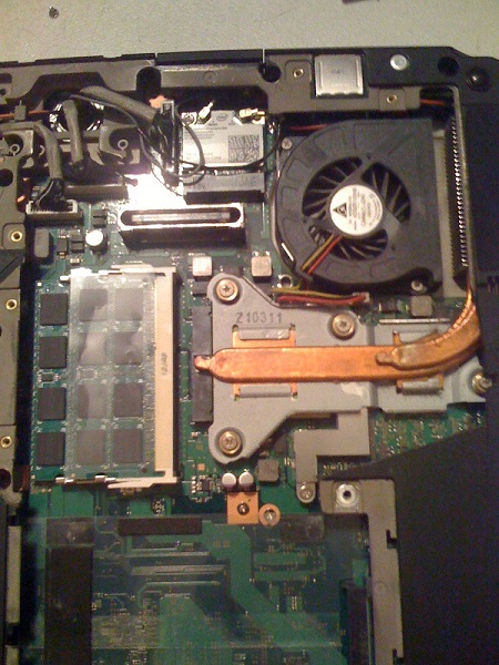

  17. Oh wow, that is quite a huge difference, I'll give it a whirl. Here is a picture of the bottom of my laptop, I plan to cut a hole for the fan intake. That should help dramatically (hopefully). I'll take a picture of it's innards and upload it when I get home.
