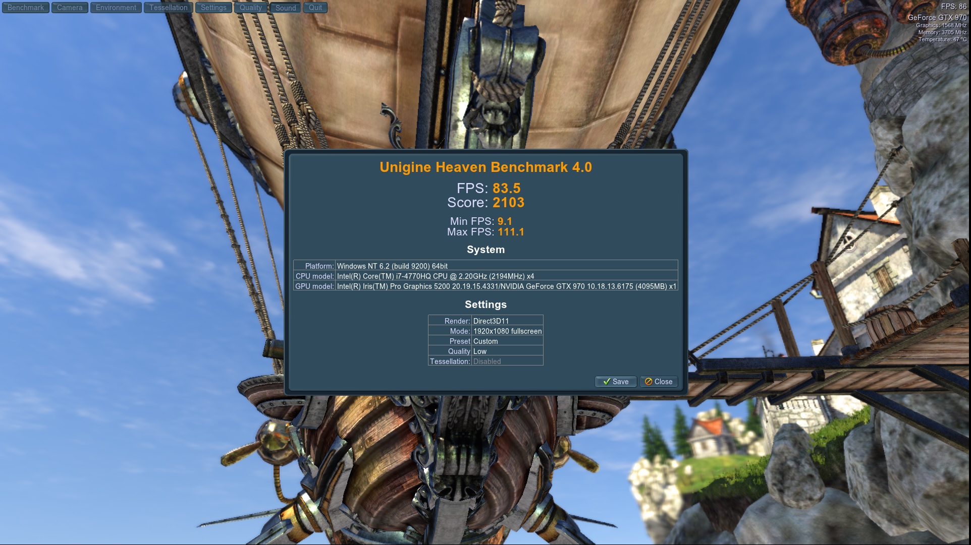

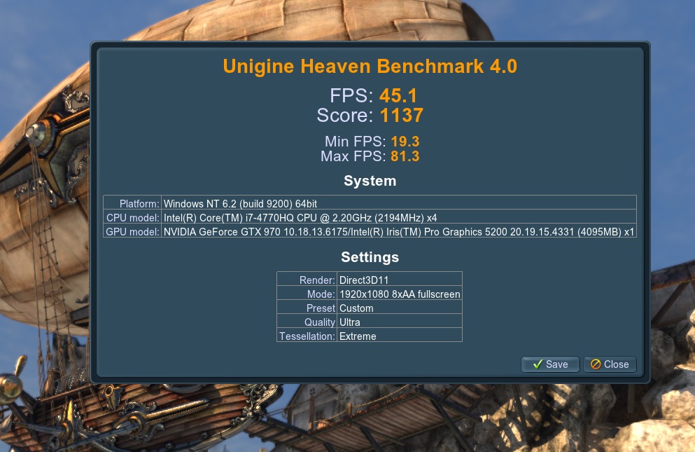

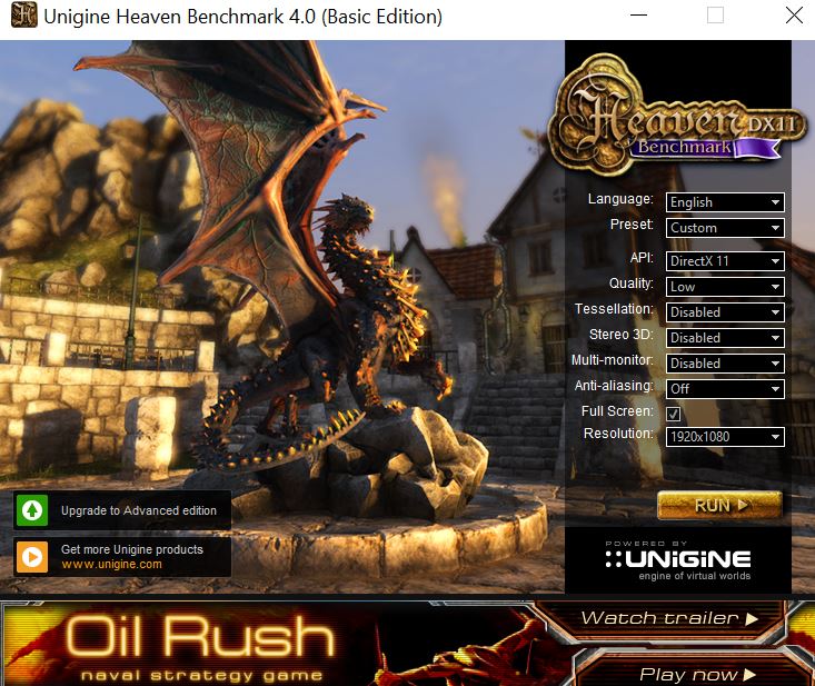

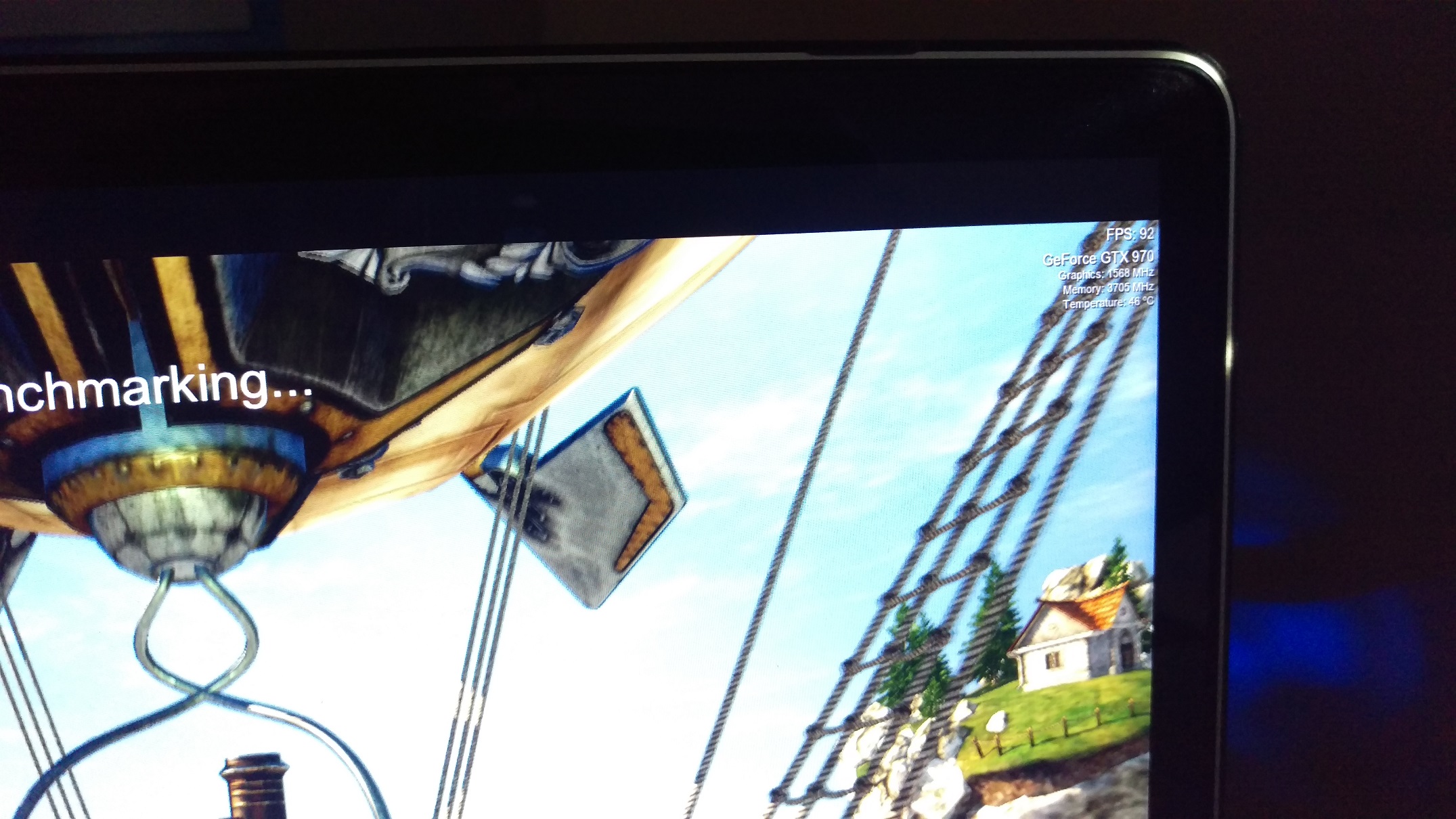

  3. @Dschijn No, the internal display for me isn't limited to 60fps. Tested Heaven at very low settings As you can see, it is at 92 fps here. But, the results were a lot lower than I anticipated for such a reduction in quality from extreme (only rose maybe 1000 points at the most). @DschijnMaybe vsync is on somewhere?

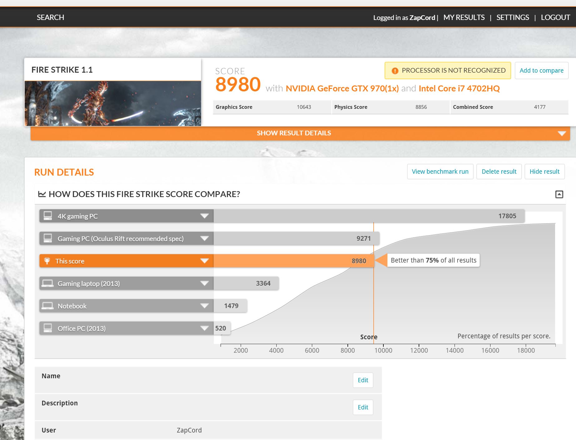

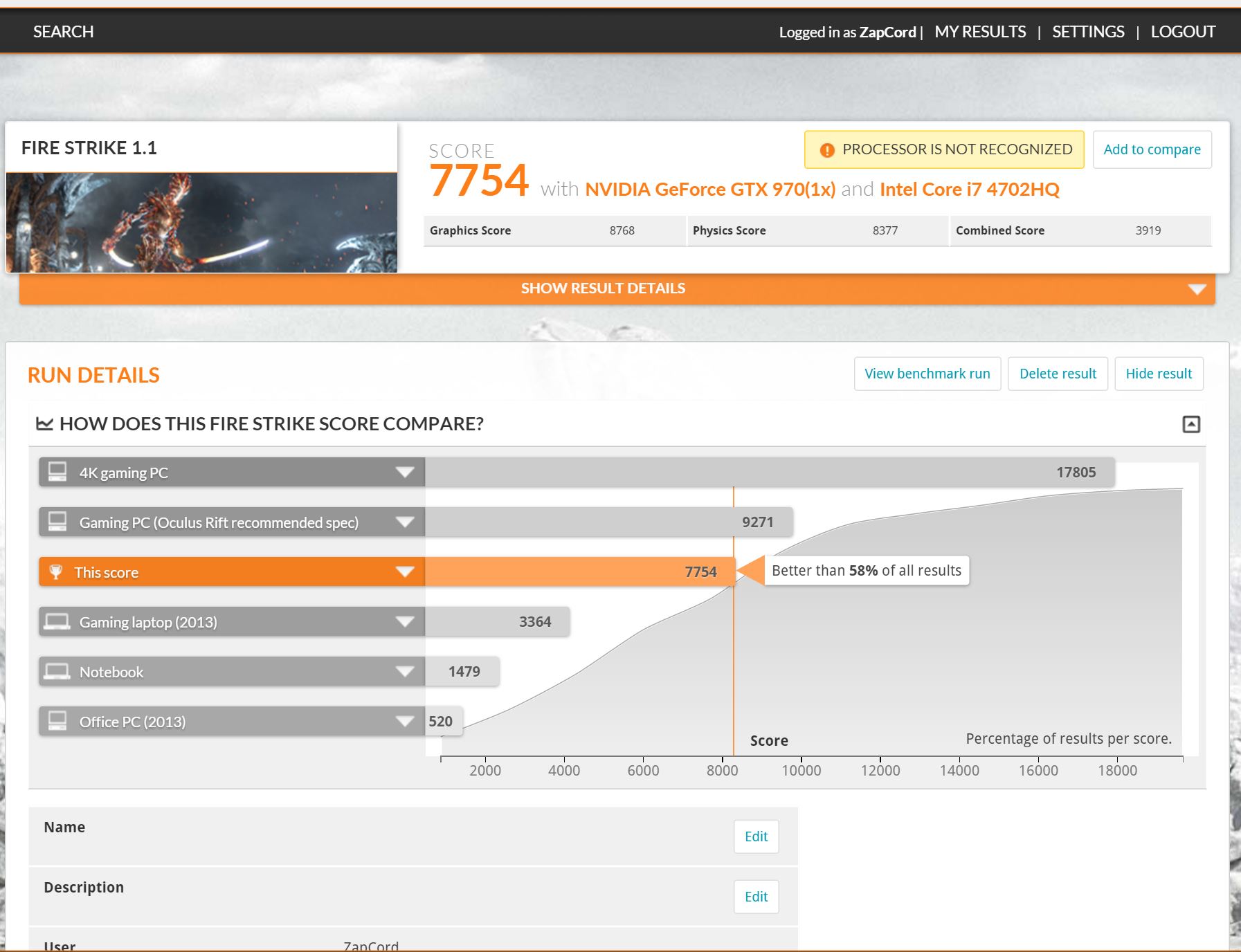

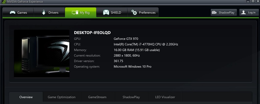

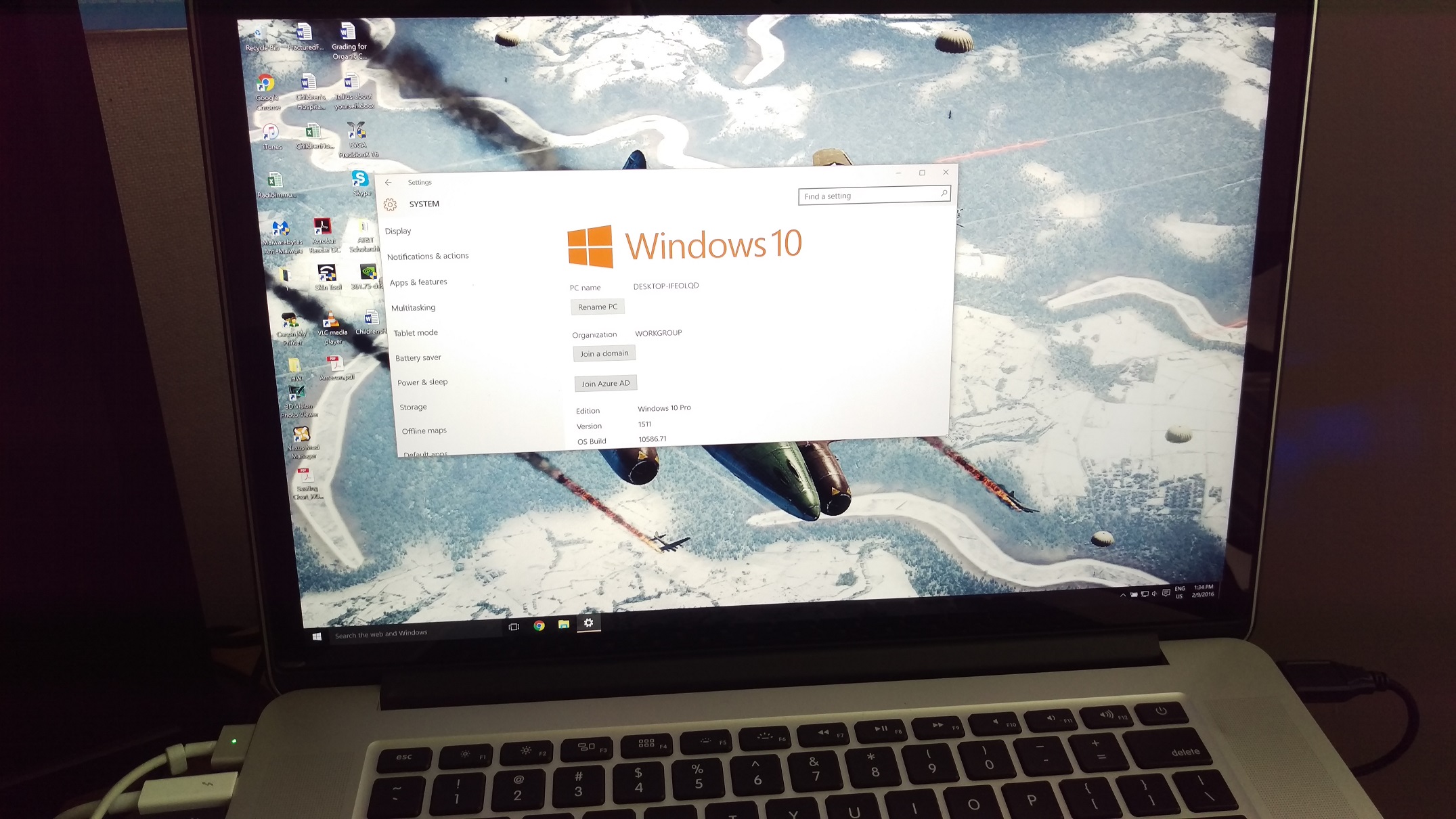

  5. Anyways, time for me to upload my proof. Using this Boot procedure: I decided to run firestrike from the 3dMark demo on steam with only the internal display on (no external monitors plugged in) to show everyone optimus works in Windows 10 (at least for the mid 2014 15in MBP Iris Only...still need confirmation for other systems) Note the display size and the operating system. 2880 x 1800 is obviously the internal display for 15" Macbook Pros since 2012. But, Geforce experience doesn't show you the performance. Here is my 3Dmark Result with the internal display: http://www.3dmark.com/3dm/10694991? Compare this with the 3DMark Result on an external display with the same clock speeds: http://www.3dmark.com/fs/7439086 These results are totally consistent with the performance loss (-14% performance) due to Optimus. It is also quite obvious that the egpu is working with a score of ~7700 in firestrike. Hence, please continue to ask me questions and don't give up on Windows 10 so easily! I will try my best to answer ones I know about. @Dschijn can answer the rest -ZapCord

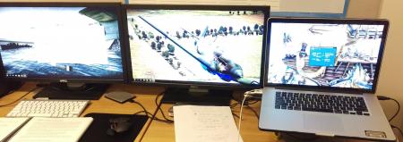

  7. @stemoac interesting, maybe try booting up with only the egpu and internal monitor connected at first (same procedure) and then connect the external monitor to the gpu after boot. You'll get a few screen flickers right after boot but it is ok. Are you sure you are using driver version 361.75? My setup during the test was: GTX 970 with 361.75 (none of this worked pre 361.75 and the computer was using integrated only on internal display) 2 1920x1080 external monitors connected by DVI Internal display was primary display. -All of these were on extended display mode.
  8. @stemoac Greetings! It is very much possible to run both displays with nvidia. However, the internal display will not show the egpu as its display adapter. -That is due to the fact that the internal display is connected to the integrated graphics no matter what; however, the brunt-work is still handled by the egpu. You can see this in the spoiler below. -Notice that the score is a little bit less than the one I posted above in my original post as it is run on the internal monitor. -That is due to the inefficiency of having to route all traffic through the integrated graphics no matter what for the internal display. I hope this clears it up! EDIT: grammar errors

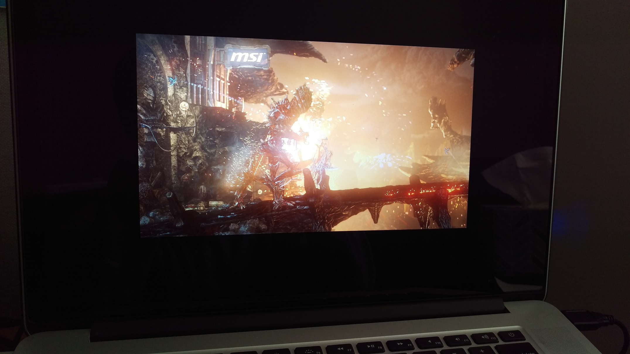

  10. CAN CONFIRM OPTIMUS NOW WORKS!!! Tested on Warframe and the game looks nice on the internal screen (yay). To get Optimus working on Windows 10, install driver version 361.75 released 1/27/2016 Boot procedure is now: plug everything in start egpu start laptop wait 30 seconds boot Profit Big Thanks to Everyone!
