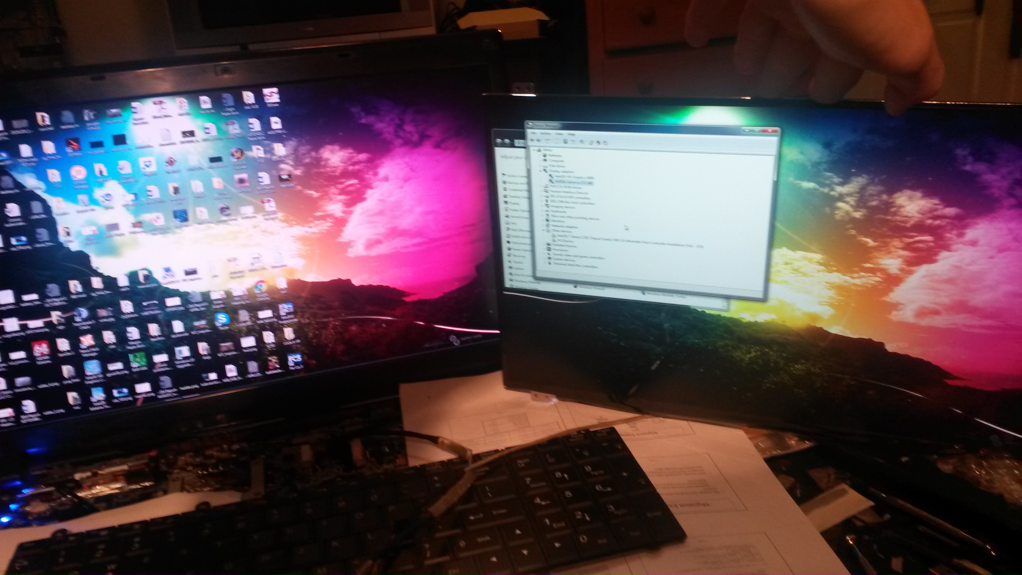

  14. @Prema modified me another vBIOS for the 980 and now P0 and display on boot work with the 980 core switched over to an MSI 980m board (I damaged the clevo 980m board when switching memory chips). There seems to be something wrong with the P150EM system BIOS that is compensated for by a modified vBIOS. An added bonus is the memory now clocks higher than ever with 7.8 GHz usable in benchmarks. I got a 3K display, but am having problems getting a 40-pin eDP cable that's close enough to modify. Here's an interesting picture from September where I was running both LVDS and eDP at the same time. Unfortunately the picture quality was poor.
