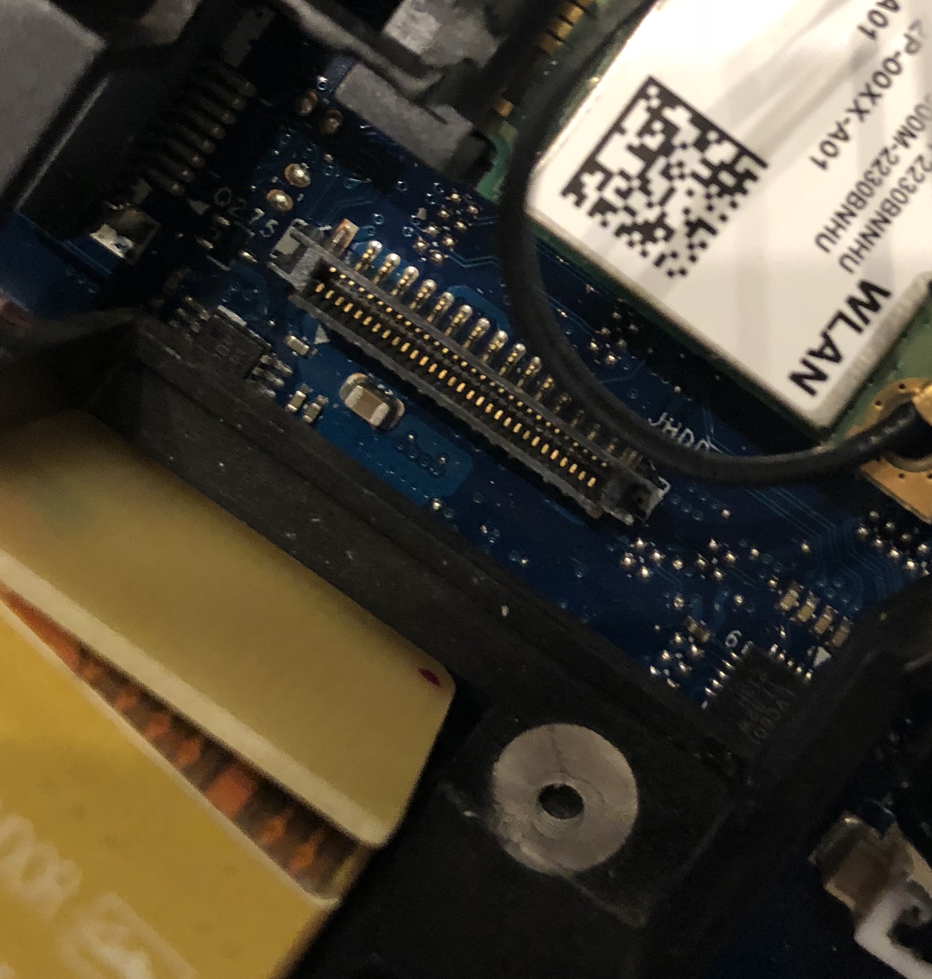

Hard drive plastic clip. Any idea where to get?
ServusFidelis replied to ServusFidelis's topic in Alienware M18x / AW 18
Well, it’s a fix I guess. I cut plastic from an items (a flash drives clear plastic packaging) I bought. Then I wedged it in front of the cable to hold it in place. Hard drive reads again , but I’m not sure how stable or consistent it will be. I’ll probably also put a short piece of electrical tape over it. Right now though I’m busy trying to get my gpu to work right in another m18xr2 forum. -

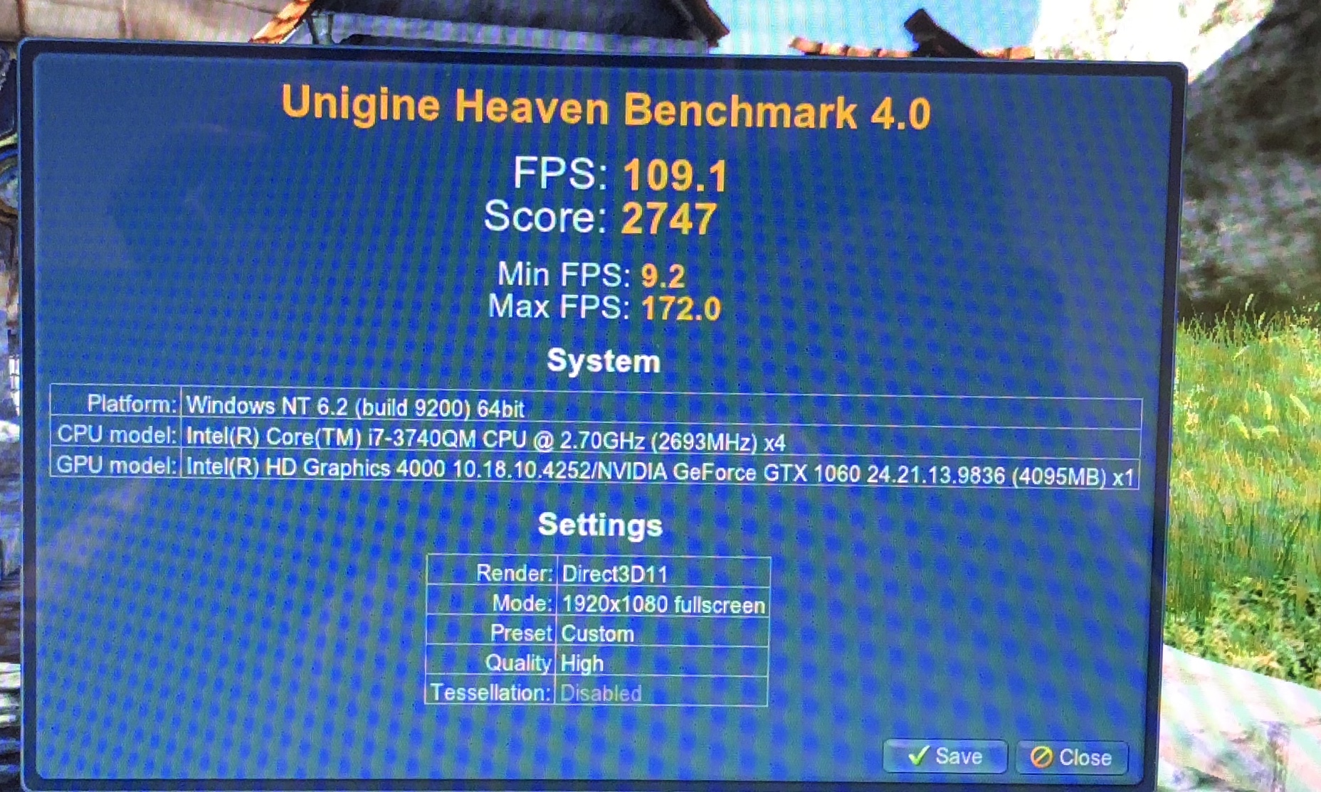

Well no more 8 beeps and the screen comes on and boots into Windows. The only problem now is the Alienware doesn’t detect a discrete graphics card in the bios and simply loads the intel 4000 graphics. Any idea what could be the issue? -
Sorry for lighting up the forums lately. Installed slv’s wonderful bios. Everything is now going good except bios says no discrete graphics are detected. Any any help would be wonderful.
