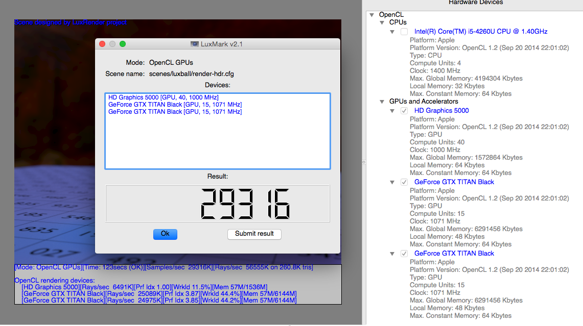

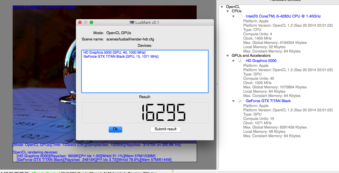

  9. I think you should have stayed with 780. OS X can't use both cores it seems. Here is a single Titan Black on a 1.4Ghz Mini Note that if you drag the score Window to left (over the ball) then everyone can see what was tested. I'll plug in a 2nd Black and update this. UPDATE: 2nd Black nearly doubled score. Fast cards. BTW, if you want to be able to compare easily you might want to run the "Sala" or "Room" scenes as Barefeats uses those frequently. Also, you can attach here instead of off site, easier for others to see.
