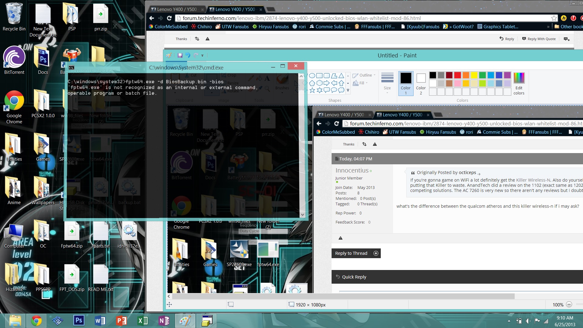

EDIT: okay now i can't boot into my USB these are the files' placements and i formatted the USB with the tool and have USB boot enabled in the BIOS so please tell me what is wrong
Yup, after you formatted with the DOS formatting tool of course.
thank you, will report back after i've done this. BTW whats the worst that could happen if i mod my bios?
so i have to copy the folder win98 to the root of the empty formatted drive?
kudos my friend. Don't worry i also suck at english haha and in Prepare an USB stick which can boot DOS. If you don't know how to do this, follow this short guide:" should the USB pen drive be empty? What I mean here is AFTER the format with the utility and the whole win98 folder thing because AFTER this my USB is empty after the format
how can i backup my bios? i am stuck on this problem please help
