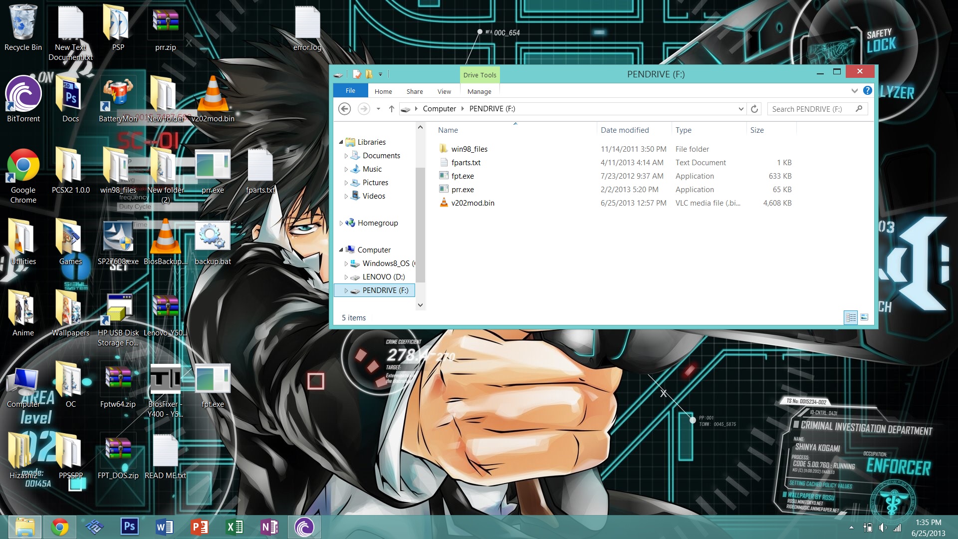

okie dokie thanks again for assisting me my friend EDIT: okay now i can't boot into my USB these are the files' placements and i formatted the USB with the tool and have USB boot enabled in the BIOS so please tell me what is wrong -

so i have to copy the folder win98 to the root of the empty formatted drive?
