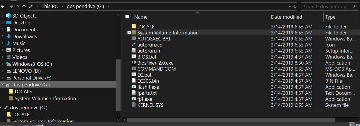

I have to give my review from someone very inexperienced..  and say I will need some help to complete this flash to my y510p.  I guess things went real smooth until I found out that the video was removed and I seemed unable to complete making a copy of my bios and drag/drop to place on my pen drive.  I used rufus to make the boot drive but when I tried to flash the bios didn't stick but the ec did.  I was able to boot back up and bring my bios back to 3.05.  After running through the process again when I got to the point of taking the bios back to version 207(stock) I received a warning that my bios did not match?...  Went to Lenovo to download and reinstall the bios(v3.05) but they have moved up to 3.08 now so I did not install it.  Perhaps someone could tell me how to get back on track and be successful with this.  My 7260 is burning a hole in the package it came in.....
Below Is the final result of my pen drive contents......
