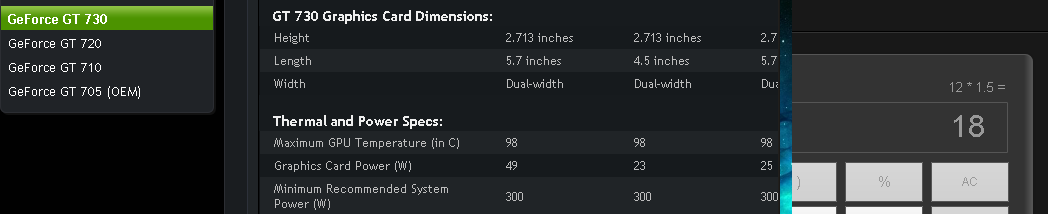

8 hours ago, arqueiro said:
Video Board: Nvidia GT 730
I'm also not using an PC energy supply since this is a low end Video Board, I'm just using an external 12v 1.5 A power supply..
Do you see what your problem is?
You need more power.
Either use a 12V brick with more amperage or simply find an ATX PSU. You should be able to find one used for $15 on the local classifieds.
