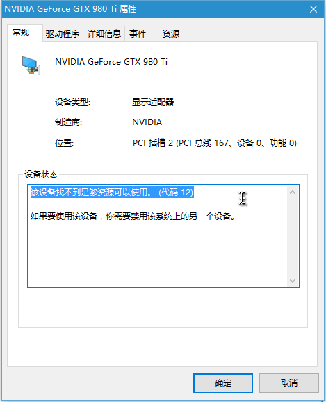

however, i just cant get it working in windows 10, just like this:
and i got this Error 12 (Code 12), This device cannot find enough free resources that it can use

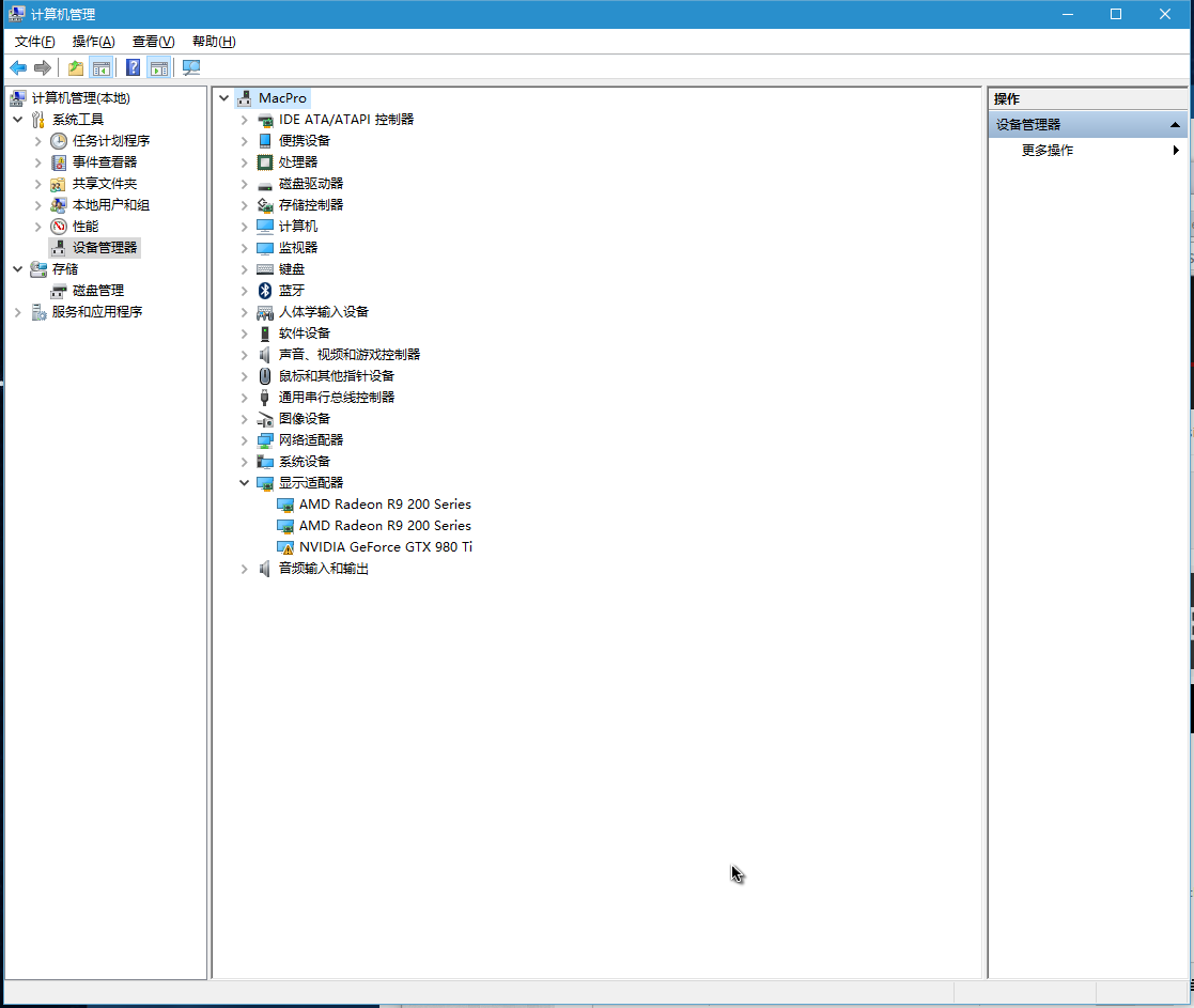

i tried to disable my two D300 video cards, still, the 980 Ti wont able to start
