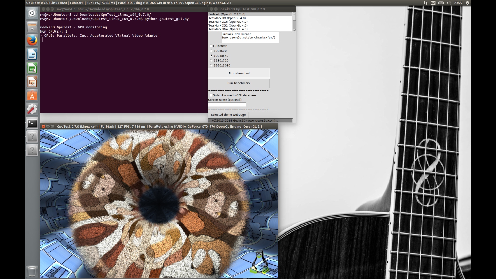

I just updated the eGPU stuff on OS X 10.11.1 and launched the Ubuntu VM, started a tool called "GpuTest" for Linux and ran Furmark on 1024x768. I was surprised by the FPS it gave which were about 120. Then I saw that the title contained "Parallels using Nvidia GTX 970 OpenGL Engine" and I also heard the fans of the eGPU spinning up. I had started the VM on the external screen but didn't think about the eGPU at that moment, I just wanted to have it on the big screen.

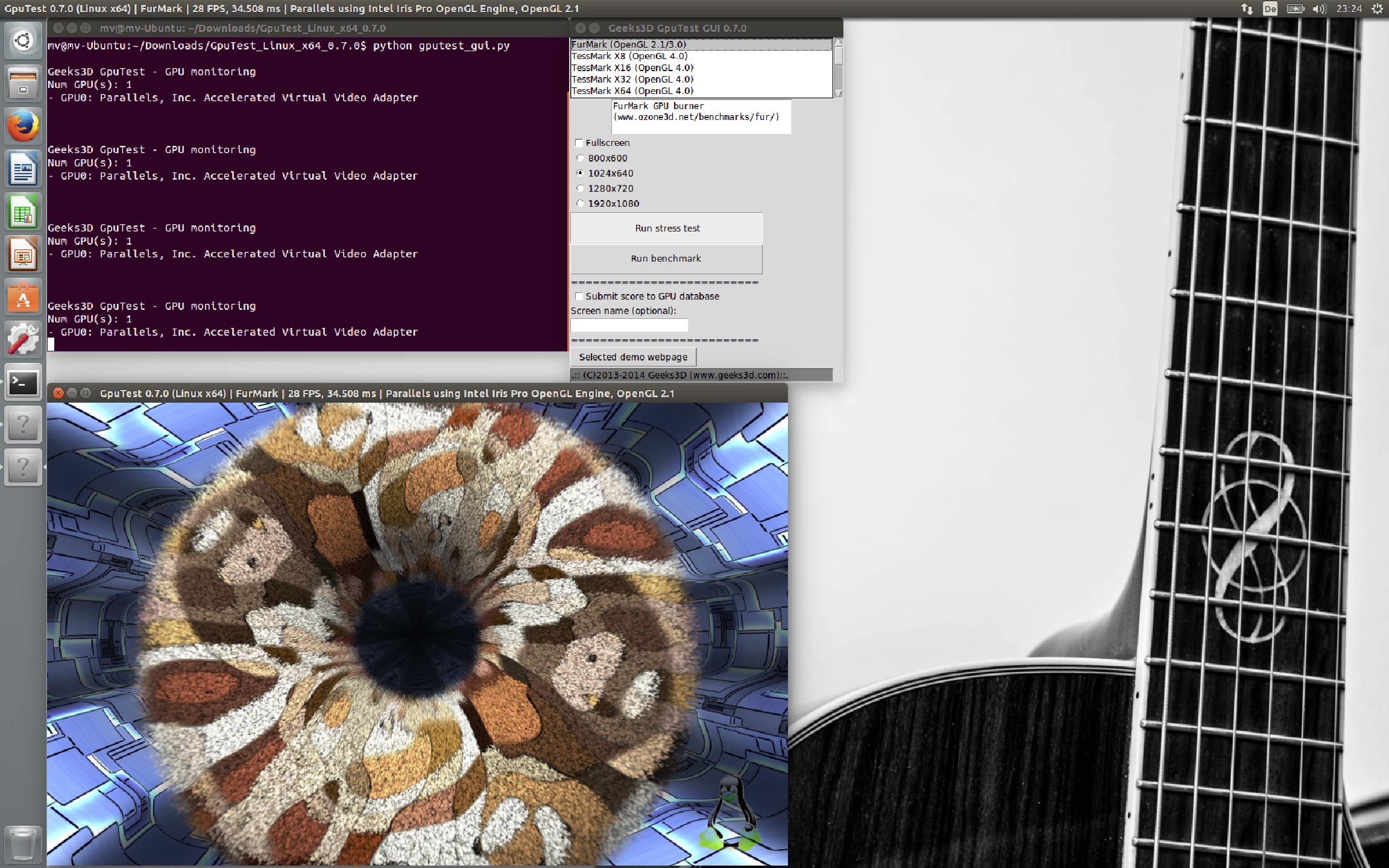

To check for the impact the eGPU has I shut down the VM and started it again on the internal screen without eGPU acceleration. The title now contained "Parallels using Intel Iris Pro OpenGL Engine" and the FPS were only about 28. So the eGPU actually has a huge impact on the performance, roughly by a factor of 4.

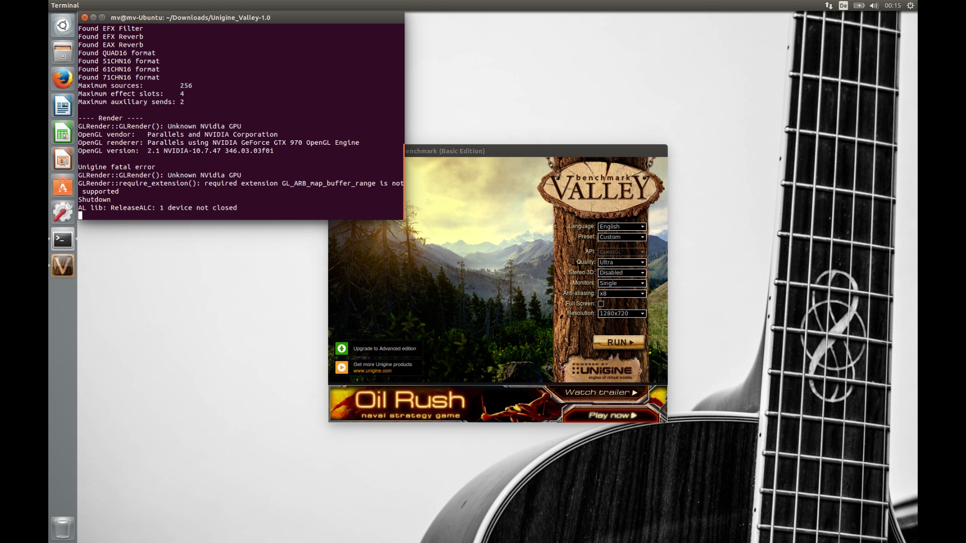

I then tried to run Unigine Valley to have a comparison to the native OS X performance but sadly the driver has a limited set of supported OpenGL features and Unigine Valley won't run.

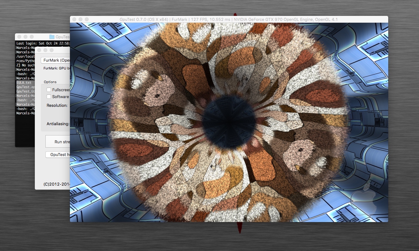

Still, I downloaded the "GpuTest" tool for OS X and started Furmark and hey, it's also got roughly around 120 FPS with the same settings :-O
So, the raw performance of the graphics card seems to be pretty straight passed through to the virtual machine with Parallels. The only limiting thing is the graphics driver and it's support for OpenGL features(I guess it's the same for DirectX) for the virtual machine provided by Parallels.
Furmark Parallels iGPU:
Furmark Parallels eGPU:
Furmark OS X:
Unigine Valley Parallels eGPU:
