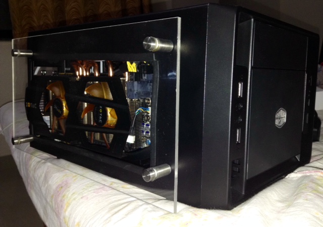

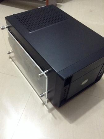

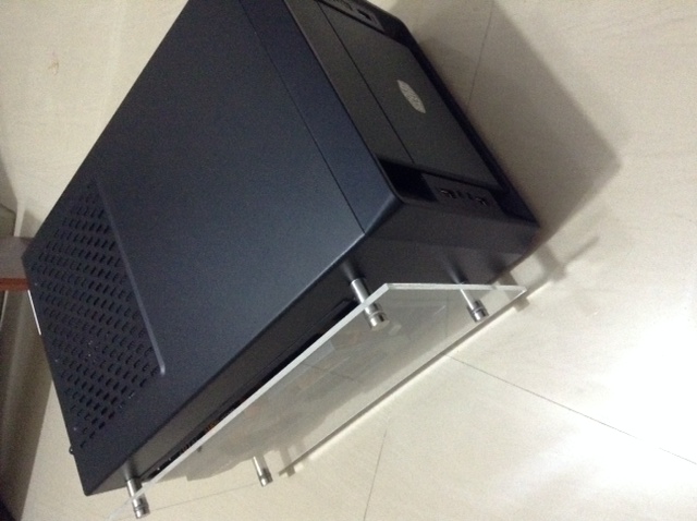

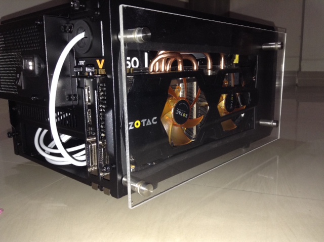

Also I've brought cooler master elite 120 case and modded it a bit to accomodate the bulging out of the GPU via cutting one side of the case and adding an acrylic sheet on it. Although its a full fledged case for mini ITX form factor, using it for just an eGPU is cool since its not that huge and also I am going to keep on my computer desk where space will not be an issue.
Let me know if some one wants detailed steps I followed. Special thanks to Tech Inferno Fan and all the other members of this community :sneakiness:
Pics of Case:
