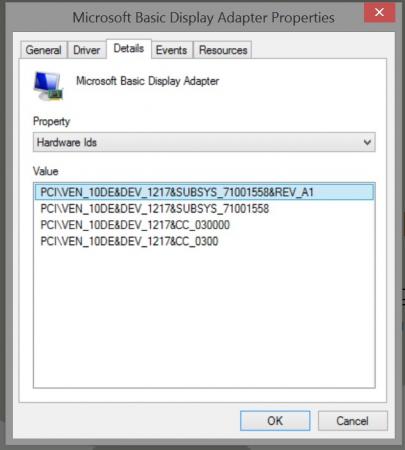

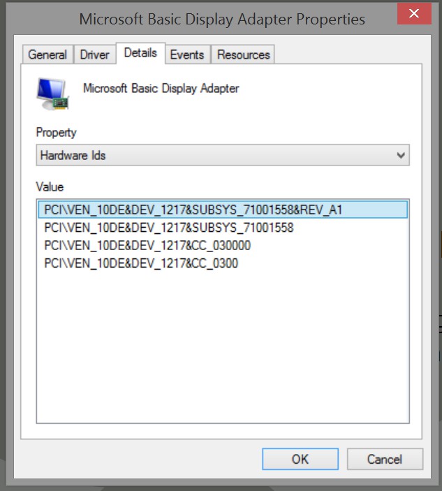

When I flash stock 675M vBIOS it has 1212 HWID. However when I flash any of the 580M vBIOSes it change to 1211 in DOS but when I restart notebook i has 1217 in Windows. When I return to DOS and check (nvflash -- list) it has 1217. :)
I've tried flash 580M vBIOS and turn off and disconnect AC adapter for 10 minutes. After restart it has 1217 in DOS and Windows. It only has 1211 till restart notebook. :D
