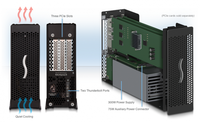

NOTE: This enclosure can host a dual-width and full length x16 video card but has it's 300W PSU limited by wiring to only supply 150W. Four workarounds can get around that power limitation (1) use a splitter to *safely* access at least another 75W as demonstrated at http://forum.techinferno.com/implementation-guides/7854-%5Bguide%5D-2014-15-macbook-pro-iris-gtx980%4016gbps-tb2-sonnet-ee-iii-d-win8-1-a.html#post107417 though it's suggest here that the III-D 6P PCIe connector cabling could provide the full extra 150W, (2) use an external PSU to supply more power as at http://forum.techinferno.com/implementation-guides/6689-%5Bguide%5D-2013-15-macbook-pro-gt750m-gtx780ti%4016gbps-tb2-sonnet-ee-iii-d-win8-1-a.html#post91182 (3) use EVGA Power Boost to draw an additional 75W from each of the 2 unused slots (max 150W) as discussed in the spoiler or (4) mod the PSU with additional PCIe connectors crimped onto the ring terminals as shown at http://forum.techinferno.com/implementation-guides/7685-%5Bguide%5D-2013-11-macbook-air-titan%4010gbps-tb1-sonnet-ee-iii-d-osx10-9-4-a.html#post105280 .

Specifications
Quote
Part No: ECHO-EXP3FD     Echo Express III-D Desktop Thunderbolt 2 Expansion Chassis for PCIe Cards(1)
Hardware Warranty:     5-year
Dimensions: (WxDxH)     3.8 x 16 x 10.2 in. (9.7 x 40.5 x 25.9 cm)
Weight: 7.5 lbs (3.4 kg)
Form Factor:     Desktop
External Connectors:     Two Thunderbolt
Internal Connector:     6-pin Mini-Fit Jr (same type as on legacy Mac Pro motherboard; provides up to 75W of power for PCIe cards that require supplemental power)
Expansion Slots:
- One x8 mechanical (x8 electrical) PCIe 2.0
- One x16 mechanical (x8 electrical) PCIe 2.0
- One x8 mechanical (x4 electrical) PCIe 2.0
PCIe Cards Supported(1)
-One full length, full-height, double-width PCIe card, plus one single-width card
-OR three full length, full-height, single-width PCIe cards
Compatible PCIe Cards(2):     Up-to-date PCIe cards listed on our supporting PCIe Card Thunderbolt Compatibility Chart
Power Supply:     Universal 300W, 115-230V AC, 50-60 Hz(5)
Operating Temperature: 0˚ C to 35˚ C (32˚ F to 95˚ F)
RoHS Compliant: Yes
Package Contents:
- Echo Express III-D chassis(1)
- Power cord
- Thunderbolt cable
- Thunderbolt cable lock(3)
- Documentation
