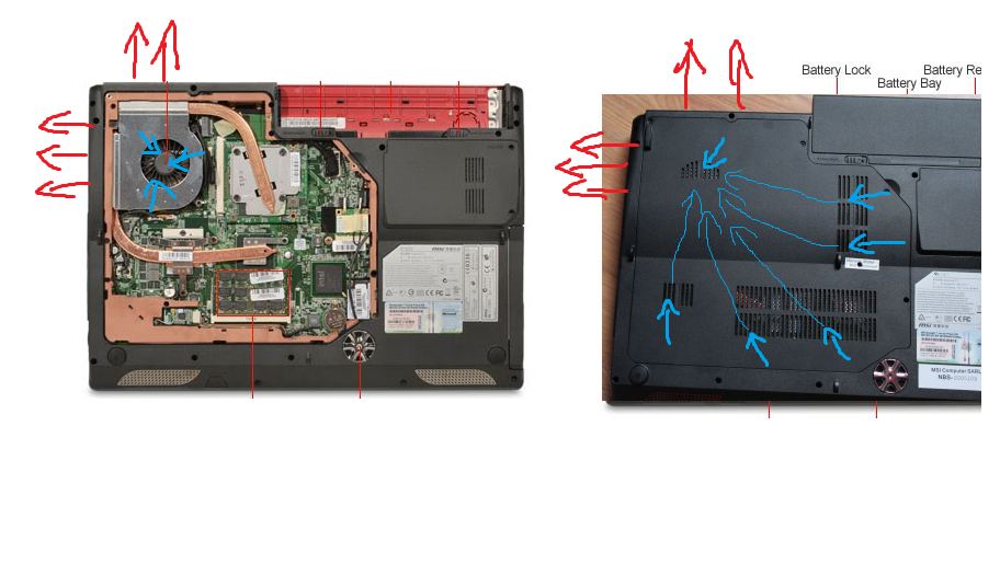

Does the fan fit inside and you can still close the bottom cover ??
- do NOT keep the bottom cover open! - it is there for a reason, it helps the airflow, the main fan is sucking the air from the holes in the bottom cover, the air helps to cool the GPU on its way to fan itself and then cools the radiator on the heatsink, If you open the bottom cover, there is no airflow!
HD 7970m uses 28nm technology. - it runs even cooler than 6990m or GTX580m!
There are good chances you will even decrease temps by doing this upgrade!
Happened to me on MSI GT780. gtx580m (40nm technology) was running 86°C.
Upgraded to HD7970m (28nm tech.) - twice the performance and its running 79°C max!
I'd recommend you to do the upgrade first, see how it works. Do some tests. After that, do some cooling modifications if you consider it necessary.
Here, see how it works with and without bottom cover:
without cover, only the fan sucks cold air.
with cover, the cold air flows through the holes, inside the chassi(thin lines), cools the components and then flows through the fan outside.
