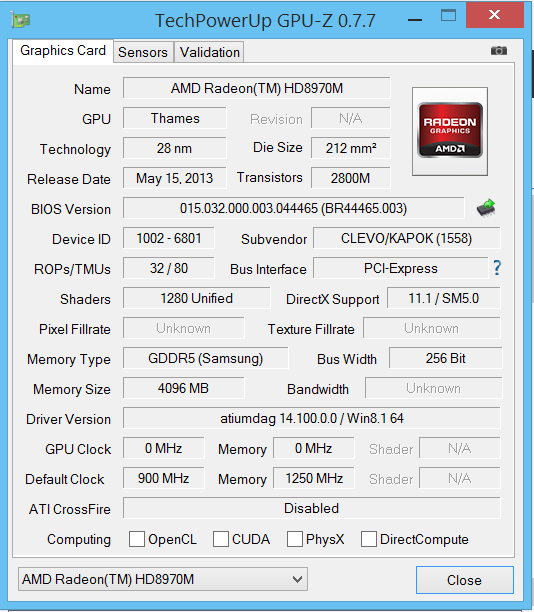

MasterInTheUniverse 17 Posted March 24, 2014 Hi to everyone! today I installed on my laptop a HD8970M / R9 M290X. This is my system Clevo P170EM - i7 3630QM - 16GB cl10 - m500 480GB - WD 750GB this is the gpu-z screen now: The vga works in gaming but i want to flash a vbios to make the system more stable where can I find it? Quote Share this post Link to post Share on other sites

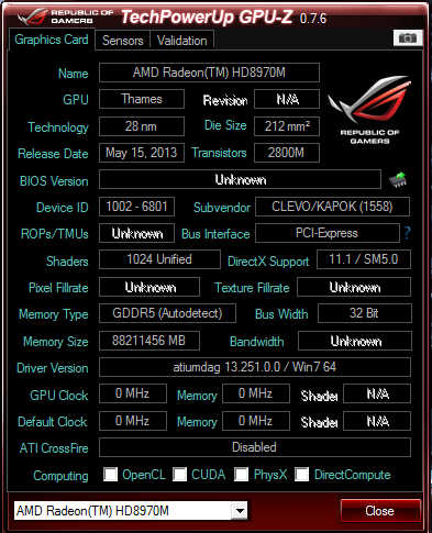

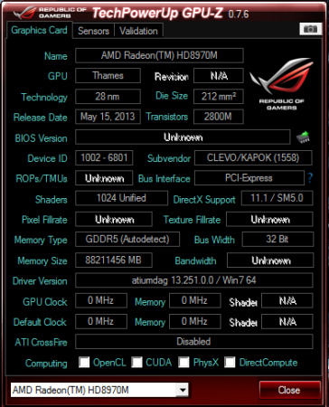

MasterInTheUniverse 17 Posted March 27, 2014 Prema helped me and I flashed the vbios...the same this vbios can't be read by gpu-z....however with overvolt in sapphire trixx I can reach very good clock on gpu (for the momento 1150 mhz) but the clock of ram is very lock... I cant improve 50mhz (1300MHZ ) either that it causes freeze.moreover the clock of the ram (1250mhz) is a bottleneck that doesn't let me enjoy the benefits of overclock on gpu clock. Infact on 3dm11 @def the score is p7250 points , with gpu overclocked only a little more....does a vbios "oc mode" exist? Quote Share this post Link to post Share on other sites
