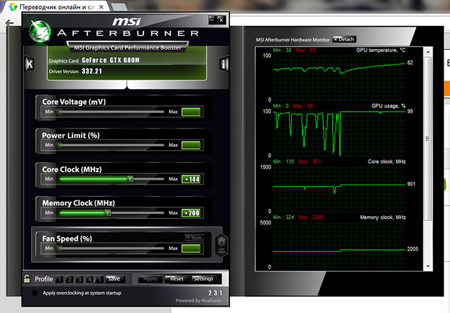

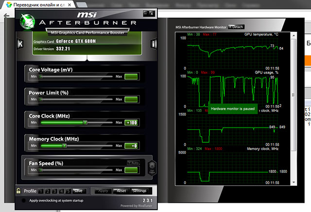

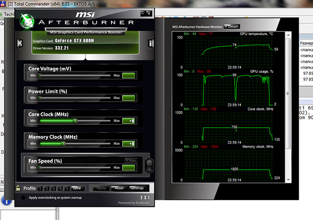

godfafa Posted March 3, 2014 Share Posted March 3, 2014 Hello, guys! Sorry for my english. I made upgrade gpu dell precision m6600 from ati 6970m to nvidia gtx680m(dell card from alienware)GTX680 was flashed with the newest bios from this site(dell 680m gtx 80.04.5b.00.02). and i get strange result. In default mode my laptop works +- normal, at load i mean. under combuster w/o oc i had various GPU load from 90 to 99%, but gpu freq is const. WTF? [ATTACH]10772[/ATTACH]Yeap throttling works at 76C. but are your bios chenge it to 85c? Freq go to down its ok. but from where these steps without frequency falling?In OC mode i have accident. more more more steps at temperature 73-74C w/o freq falling. [ATTACH]10773[/ATTACH]I download throttlestop. and i turn it on. and my laptop works perfectly. [ATTACH]10774[/ATTACH]its software problem or need some modification in my bios/vbios??what PSU are you using?Even without throttlestop, you should be able to maintain the gpu clock stable if you have enought power. Quote Link to comment Share on other sites More sharing options...
med812 Posted April 9, 2014 Author Share Posted April 9, 2014 im using standart 240w psu pa-9e. i cant get stable 99% load in kombuster of furmark w/o "throttlestop" at stock freq. Quote Link to comment Share on other sites More sharing options...
