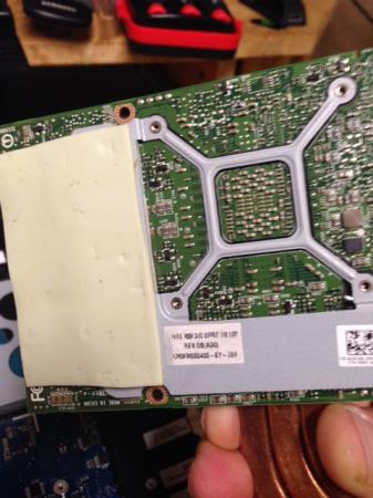

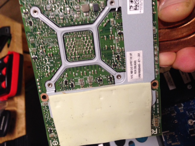

Correct, set windows power options/NV control Panel and uninstall Game Booster, under the card check that the big thermal pad is properly placed/black isolating plastic + thermal pad placement - take pics, new card ?
Uninstalled Game Booster, everything set to high performance, will check to see if the big thermal pad is properly placed (pretty sure I just left it on the back of the card when I took it out to repaste before) and thermal pad placement is probably the issue, well not as much placement but the amount of thermal pad(?) I mean, I did the two big black strips.. the two square ones, a thin strip above those, and to the right there was like a square.. I think that sums it up, but IIRC NOW... I may or may not have used the correct amount of layering for the thermal pads.. I'll have to go back to your guide, then double check again on the card, but then this will mean I have to repaste again right..? Hopefully I still have paste LOL
True, although I just realized I may have accidentally forgot to put layers of thermal pad on the thinner top parts... But it's a dell card, had the bracket pre installed and everything. I haven't really gotten to play around with the game, but the crashing worried me so I did take some pics but I didn't really get to show much.. But ill post them. Also, any reason why my CPU won't stay unparked..? when I try to manually do so in regedit nothing happens.

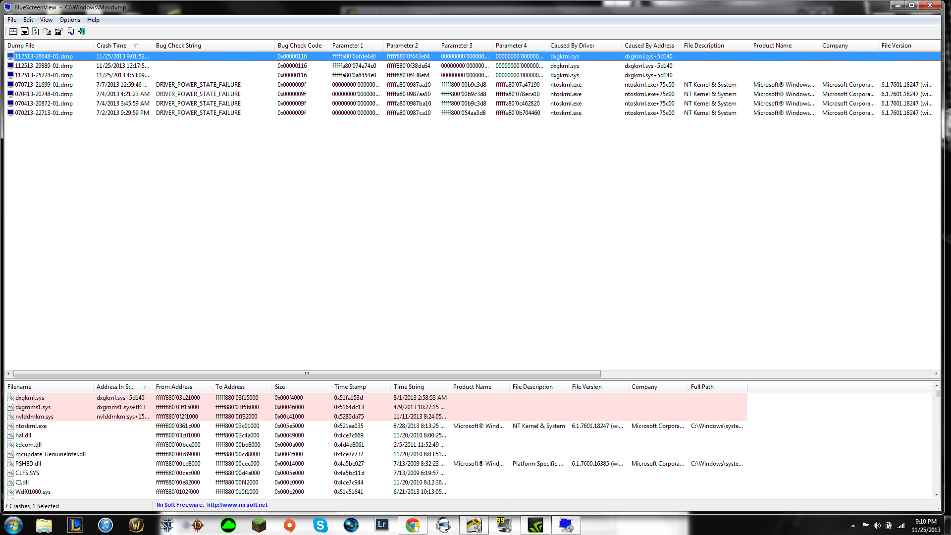

I'm crashing, just got these blue screens with some purpleness to it!?!?!?!?! Did I somehow f*ck up my mobo?????? How is this even possible, I can't find anything on these purple pixels and black screen to restart to starting to BSOD to starting to BSOD to starting fine. Temps high 61 while just browsing some internets.. couldn't get the temps before when I was playing though.. was a little choppy, got progressively worse almost it felt. Then eased up, came back in some spots. Is it because I unparked my CPU?? Could that even make these purple pixels/black screen? Or is it just something to do with the drivers this time???
Mmmmmmm great.. It works then doesn't. Getting these weird squares purple/green.. Then white, I have a pic ill post soon. If I can get it to start and stay on without crashing and freezing. I installed the 314 drivers and did okay tho so I don't really understand why it's still doing it
Well I reinstalled the newest drivers reflashed my vbios and seemed to be steady. Temps went up to like 67 during like 10 minutes of gameplay. No crashes. Left it running just on desktop wit everything closed to see if it's stable
I'm still concerned as to why temps are ranging from 55-60 degrees on idle, and also still at 75 degrees peak temps after a couple hours, and my settings were a mix of medium/low with a few high.. stable 60 frames tho, or so... was pretty stable I must say tho, I had a positive KD each game tonight, so it must be working. I just wish I could run higher then those settings without getting that tear/chop when looking around :( hopefully this stays working, I'd be quite pleased. If the temps stay around 75/under 80 that's fine? I mean I haven't seen them go over 80 and if they do I'll be sure to shutdown
Edit: RIGHT AFTER I posted this I get those purple/green squares to a freeze to a black screen to a reboot.
Problem signature:
Problem Event Name: BlueScreen
OS Version: 6.1.7601.2.1.0.768.3
Locale ID: 1033
Additional information about the problem:
BCCode: 116
BCP1: FFFFFA800D540330
BCP2: FFFFF8800F39FE64
BCP3: 0000000000000000
BCP4: 0000000000000002
OS Version: 6_1_7601
Service Pack: 1_0
Product: 768_1
Files that help describe the problem:
C:\Windows\Minidump\112713-23712-01.dmp
C:\Users\Brian Leo\AppData\Local\Temp\WER-88124-0.sysdata.xml
"windows has encountered a problem" showed that, not really sure what the hell it means or tells you.. going to google search it a bit, but damn.. can't believe that happened. It happened right after I opened up youtube, after closing my browser.
