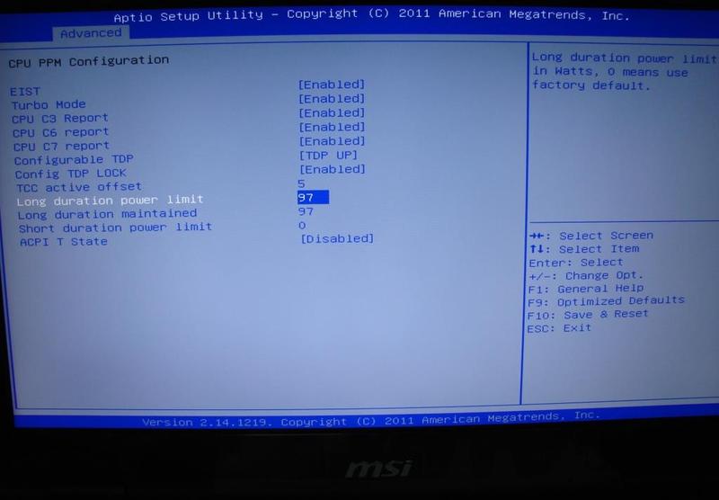

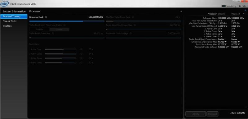

Now I want to test its unlock multipliers thru apps like XTU or Throttlestop. I manage to successfully installed and run the XTU. THe
problem is, is that the manual settings is greyed out except for reference clock... Same goes with throttlestop. Under Power Limits, i

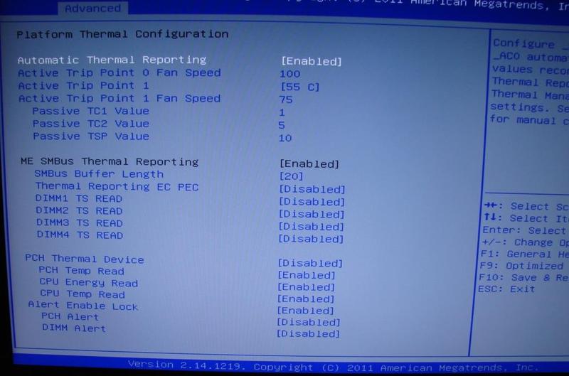

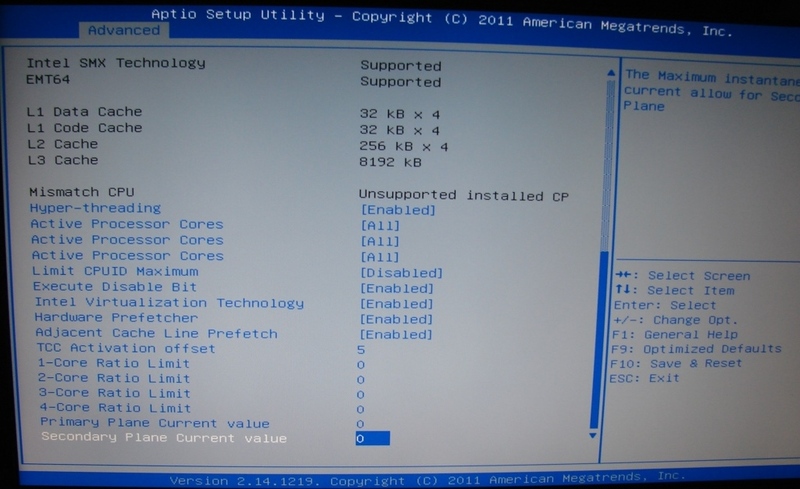

cant adjust the tdp.... Here are the images of my bios and xtu...
XTU

Hi,
In your BIOS Advanced CPU PPM Configuration switch Config TDP Lock to DISABLED
and try to set Long & Short Duration power limit to its max value, save & exit BIOS settings and try again in Intel XTU if your changes are "visible" .-)
