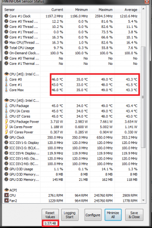

I made an attempt to lower rpms in 2570p. I soldered one N4004 diode, it was a little bit tricky because wire is a really short. It was hard to solder and make it separated from laptop. Maybe I will try tomorow solder one more diode. Even know it's a little bit hard to close bottom cover cause diode is placed on fan. There is no space left to solder two diodes in wire under fan, nearer mainboard.
Now we achieved 8460p/8470p rpms level but i'm little bit disappointed I didn't reach 2400rpms like friend above but even that laptop is significantly quieter than before mod.

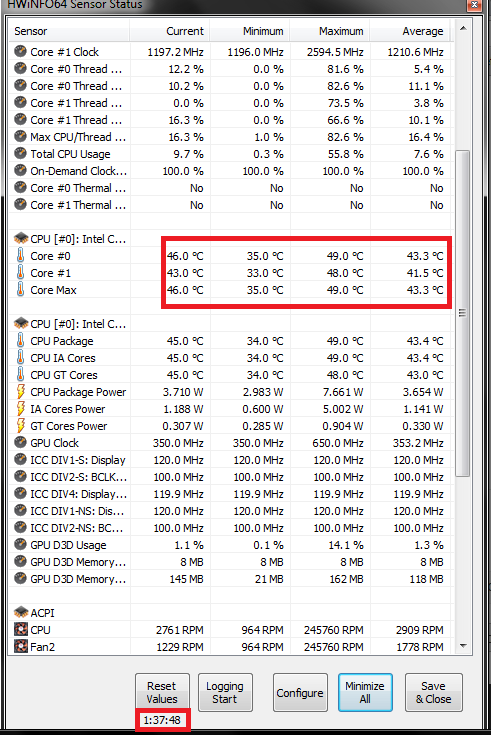

HWinfo after 1,5h using 2570p, on battery, power saving chrome x 7, foobar.
