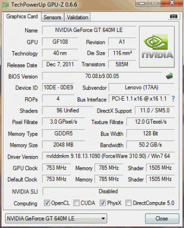

I am also interested in what the author was mentioning about the possibility of overclocking the 640m LE in the y480 similarly to that of the 640m in the sony vaio. I am already using msi afterburner, but most of the overclocking options are locked by Lenovo. An image of the gpu-z for my 640m is attached.
Thanks for the help, it is much appreciated. Please let me know if you need something else or if something can be done.
Link to gpu-z screenshot: http://gpuz.techpowerup.com/13/01/17/3vm.png
