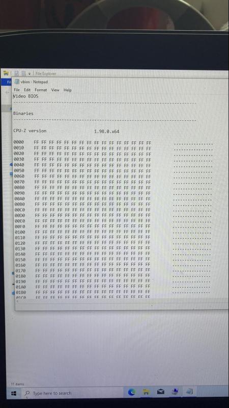

rezsoke Posted January 2, 2022 Share Posted January 2, 2022 (edited) Dear all, Dear @Klem Happy new year to you would you please to help me? I have an old asus rog g751jt, gtx970m GPU and it works only with Microsoft Basic Display Adapter driver. I have checked with gpu-z and and cpu-z aaaand the gpu bios is kinda empty :(, see attached. when I tried bioses from differenty sites I didn't succeed, because of difference in the PCI subsystem ID. Would you please please to help me? Edited January 2, 2022 by rezsoke mention an experienced staff Quote Link to comment Share on other sites More sharing options...
Bios Modder Klem Posted January 2, 2022 Bios Modder Share Posted January 2, 2022 32 minutes ago, rezsoke said: Dear all, Dear @Klem Happy new year to you would you please to help me? I have an old asus rog g751jt, gtx970m GPU and it works only with Microsoft Basic Display Adapter driver. I have checked with gpu-z and and cpu-z aaaand the gpu bios is kinda empty :(, see attached. when I tried bioses from differenty sites I didn't succeed, because of difference in the PCI subsystem ID. Would you please please to help me? Hi! Post here or send me your stock vbios. I can take a look. You can get your stock vbios by using GPU-Z utility. Also, you can get your stock vbios by using NVFlash utility. Command: nvflash64 -b vbios.rom Quote Link to comment Share on other sites More sharing options...

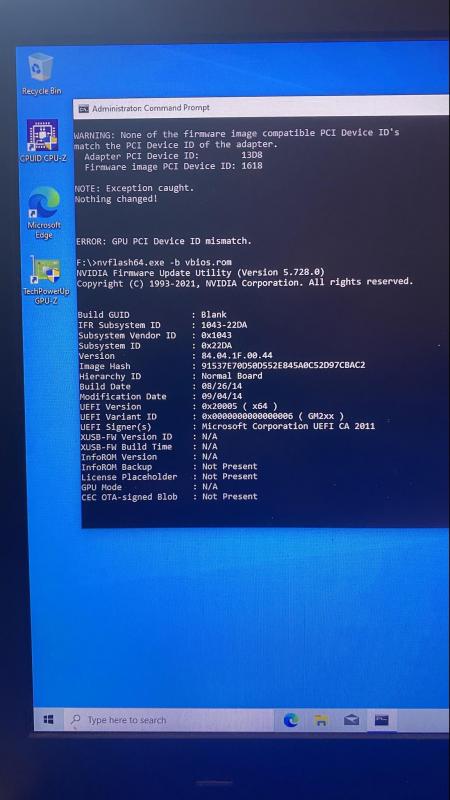

rezsoke Posted January 2, 2022 Share Posted January 2, 2022 Dear @Klem, Geez Man, this was extremely quick response!vbios.rom the forum says, it cannot be uploaded, however, it allowed me to add to post. let's try. Here is the result of nvflash64 backup Thanks! Quote Link to comment Share on other sites More sharing options...

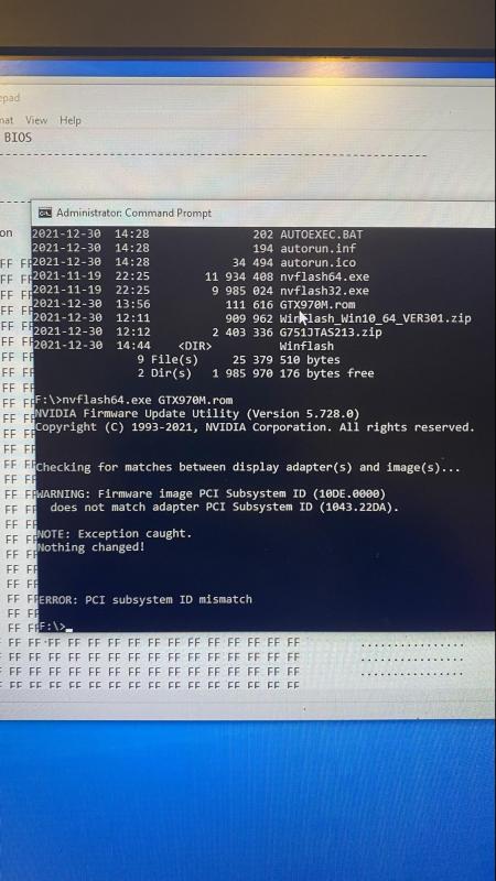

Bios Modder Klem Posted January 2, 2022 Bios Modder Share Posted January 2, 2022 Ok. Correct vbios for your laptop I placed into this link: https://files.fm/u/fgr7gvag9 1. Completely uninstall MSI Afterburner (if it installed) with all settings. Reboot laptop. 2. Download the program DDU (NVIDIA drivers uninstaller). Run it and completely uninstall all NVIDIA drivers. 3. Download and extract archive rezsoke.rar 4. Flash vbios (just run the command file flash.bat ). Reboot laptop. 5. Now install NVIDIA drivers with enabled option "Clean Install". Reboot laptop. 6. Done. Now your card should work correctly. Quote Link to comment Share on other sites More sharing options...
rezsoke Posted January 2, 2022 Share Posted January 2, 2022 Dear @Klem, I have followed your instructions (however, I didn't have any nvidia nor afterburner installed clean win10 installation to a repartitioned ssd) I got this error during flashing: The win10 is offline, because as soon as it goes online, tries to get some drivers, I think, so when the GPU is not using the Microsoft Basic Display Adapter driver, the the screen looks teared apart now I try to flash from bootable usb... maybe Quote Link to comment Share on other sites More sharing options...
Bios Modder Klem Posted January 2, 2022 Bios Modder Share Posted January 2, 2022 You can try to flash GM204.rom with using another NVFlash version. Command: nvflash64 -6 GM204.rom or nvflash -6 GM204.rom Quote Link to comment Share on other sites More sharing options...
rezsoke Posted January 2, 2022 Share Posted January 2, 2022 1 hour ago, Klem said: You can try to flash GM204.rom with using another NVFlash version. Command: nvflash64 -6 GM204.rom or nvflash -6 GM204.rom flashing was successful, thank you very much for the help @Klem! I have installed latest whql driver from nvidia, which resulted in a totally blank dark screen. Do you have any advice? Quote Link to comment Share on other sites More sharing options...
