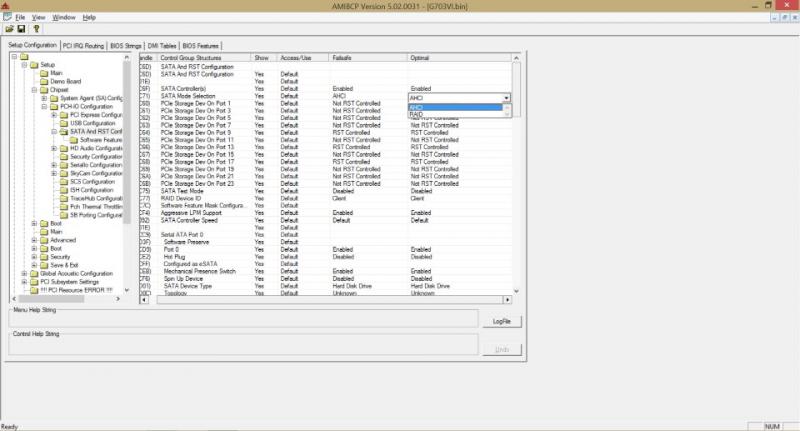

G703GX AMIBCP (Setup - Advanced - SATA Configuration) - Can choose both settings but not in the G703VI bios :

Hi!
Have you tried changing some setting in BIOS (using AMIBCP), and then flashing the already changed BIOS?
Hi Klem :)
Yes I tried to set User on all tree but the menu option choice AHCI is missing as you can see with the Setup extraction.
Need someone who can add the code they used in the G703GX and it should work.
Modify the line (0x49AF1) from RAID to AHCI will be fine for me. I don't plan to use Raid 0 anymore.

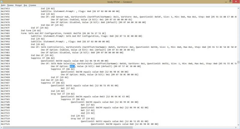

Look at these pictures, it's from G703VI :
Thanx Klem exactly the 2 entries who need to be modified in Setup : "SATA Mode Selection" (I updated bios dump version in main post)
Look those pictures I think is where the main matter is. In G703GX bios Setup you can select RAID or AHCI there, but not in G703VI Setup :
Edited by Svan
The first SATA Mode Selection entry :
374DF  : One Of Option: AHCI, Value (8 bit): 0x0 (default) {09 07 57 0C 30 00 00}
The second SATA Mode Selection entry :
0x49ABA : One Of Option: RAID, Value (8 bit): 0x1 (default) {09 07 58 0C 30 00 01}
I will edit the PE32 image in HEX and change 58 to 57. Will see if it work. Should force AHCI only.
Edited by Svan
