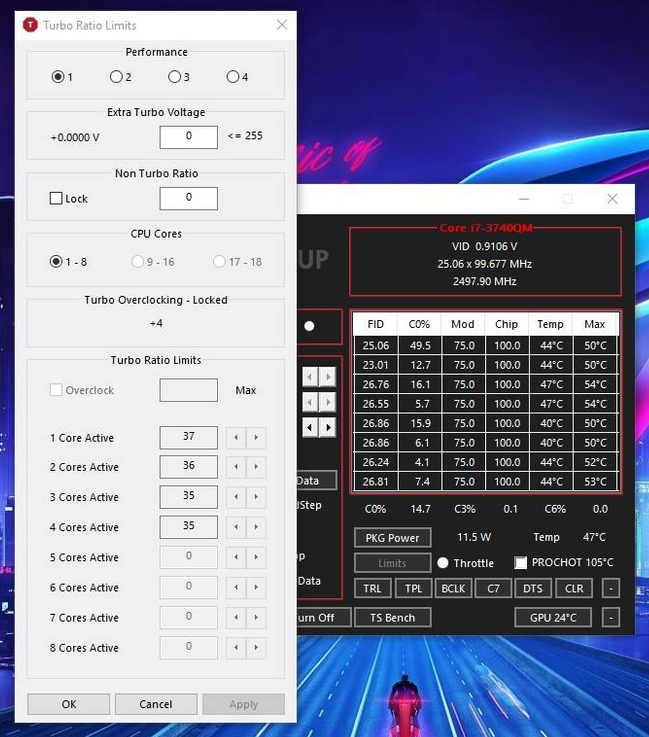

Hello, i want to know how to overclock Dell Precision M6700 Laptop
CPU : i7-3740QM i want to overclock my CPU
its currently running on 3488mhz almost 3.5ghz and its temprature is 48-54C Thermal paste using Arctic MX-4 and i dont know why my processor not even pushing 3.7Ghz Max boost
also i want to overclock my cpu properly i installed XTU but its not allowed me to go more then 35X multipler or i cant edit multipler and throttlestop is also doing same but when i see CPUZ people are overclocking their same CPU i7-3740QM someone please guide i really want to Overclock my CPU

To do what you say on the dell M6700 you must first install an XM series processor.
For example 3920XM or 3940XM
XM = Extreme Edition = Unlocked multiplier
In addition to this processor you also need a bios that allows you to change the CPU settings.
The DELL M6700 is locked by default.
Your processor is factory locked at these maximum speeds:
single core turbo 3.7ghz
dual core turbo 3.6ghz
turbo on 4 cores 3.5 ghz
As also visible from the throttlestop program
