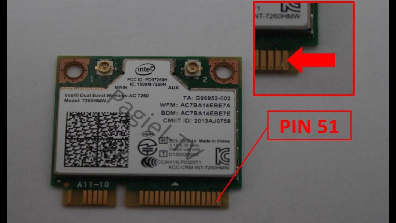

Hi!
I think you need to cover the pin 51 with tape like this:
Also try read this thread:  https://www.tonymacx86.com/threads/bcm94352hmb-bluetooth.162296/
https://osxlatitude.com/forums/topic/2925-bluetooth-firmware-uploader/page/19/

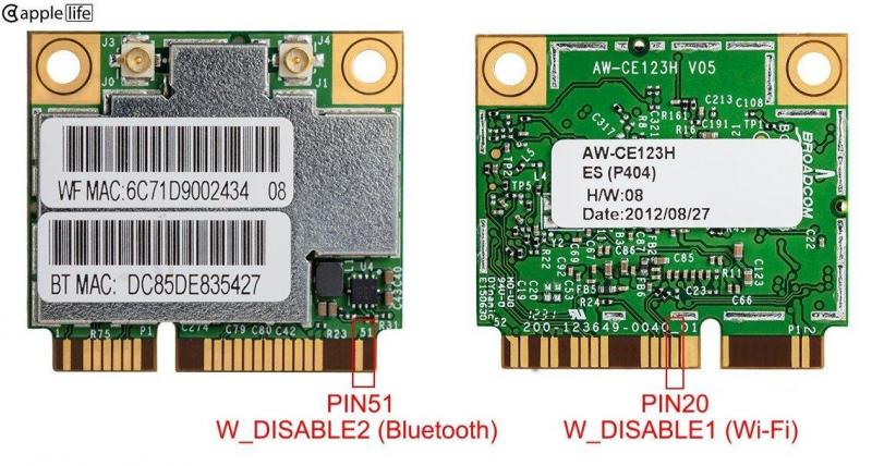

  • Bios Modder
15 minutes ago, mohali268 said:
Do you have any though why windows won’t detect it?
I think pin 51 (W_DISABLE2) for some reason get signal to disable Bluetooth part of your BCM94352HMB.
