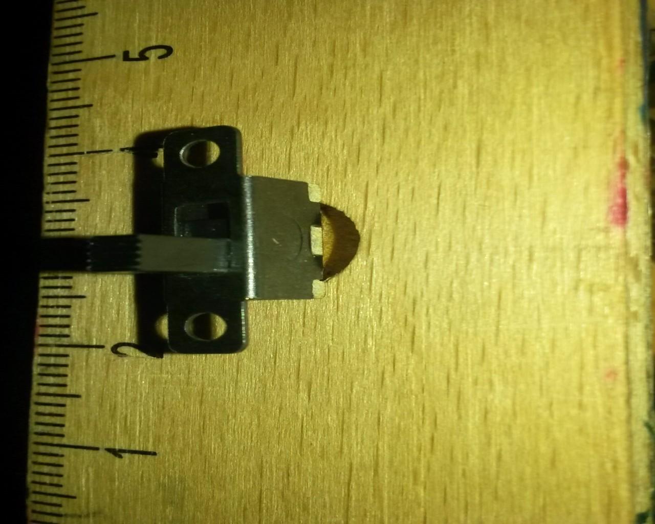

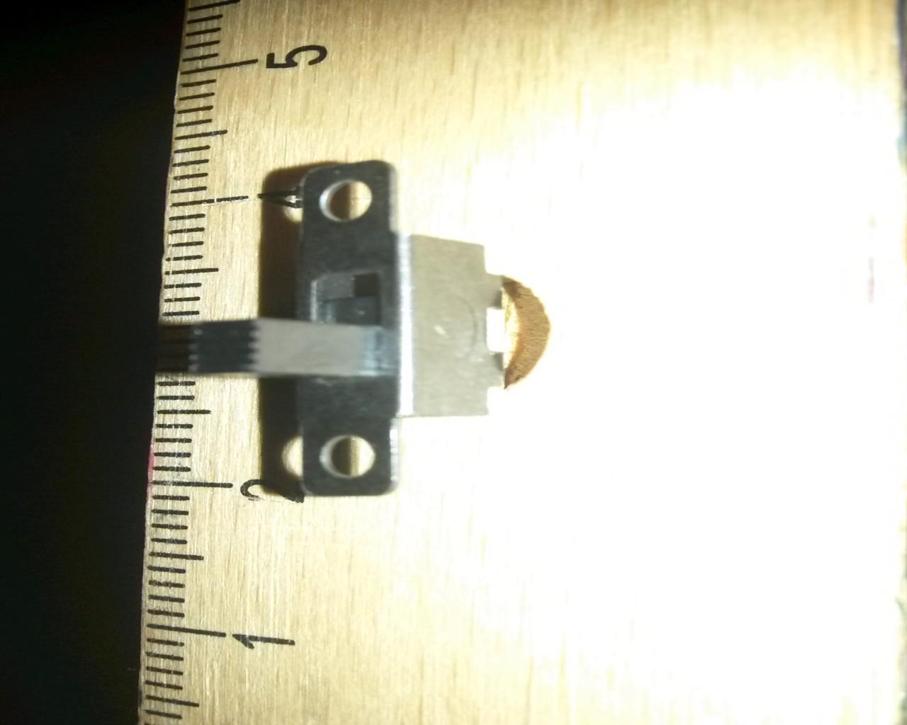

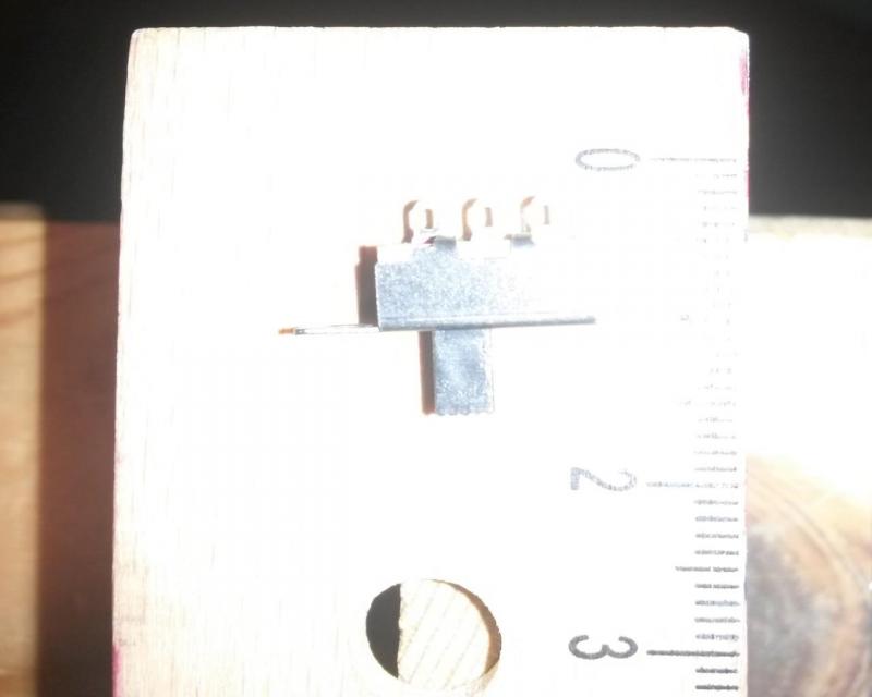

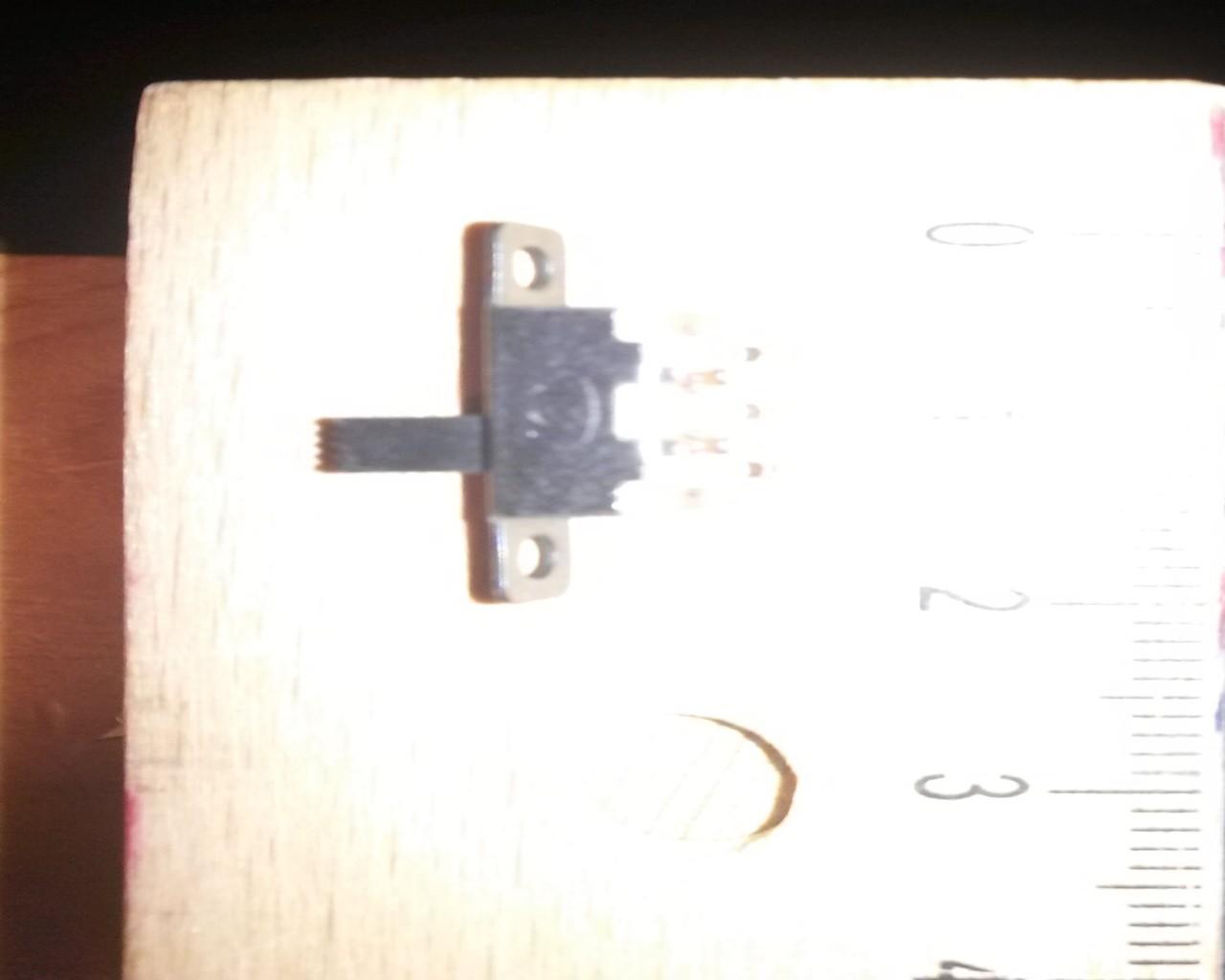

0k here it is whats mean, found an tiny analog switch first on a solar outdoor garden light later than a led and a resistor maybe than on a 0nline marktplace and or by an local rc-model dealer.

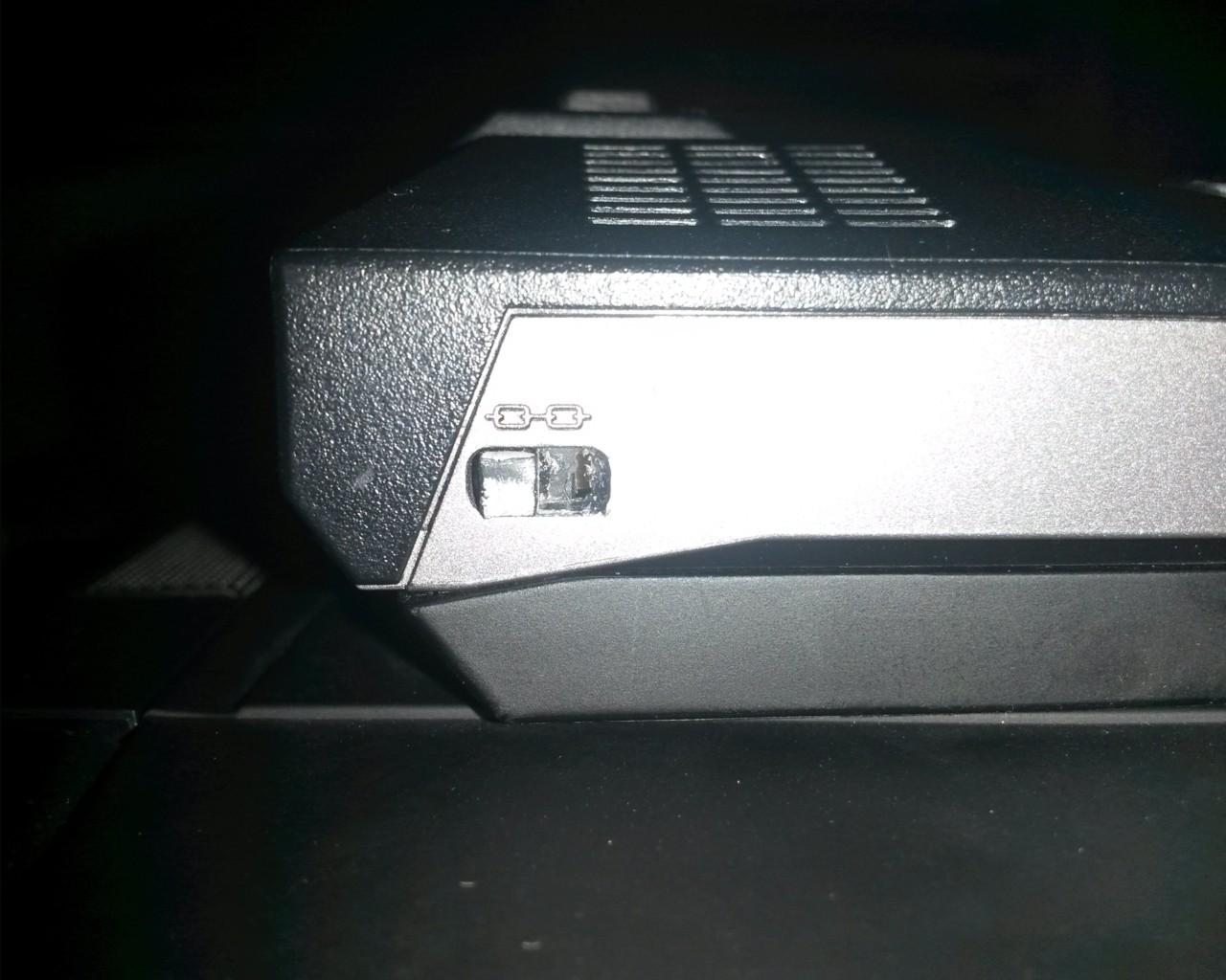

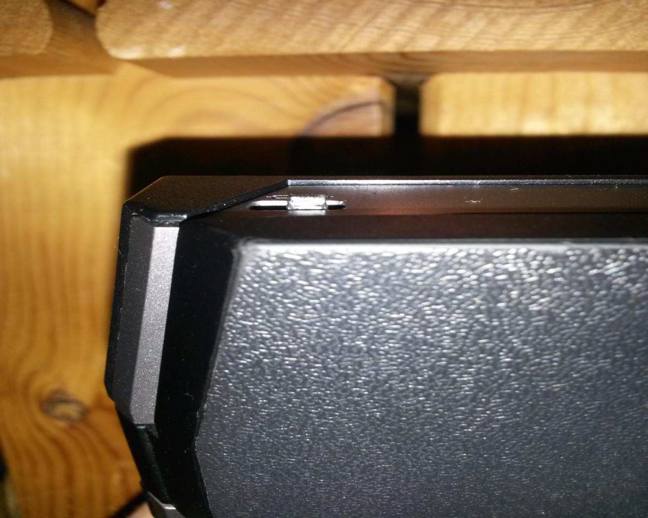

that tiny switcher fits ideal in space behind kensington lock given in the inner of chassis after remove off what made kensington part by chassis.

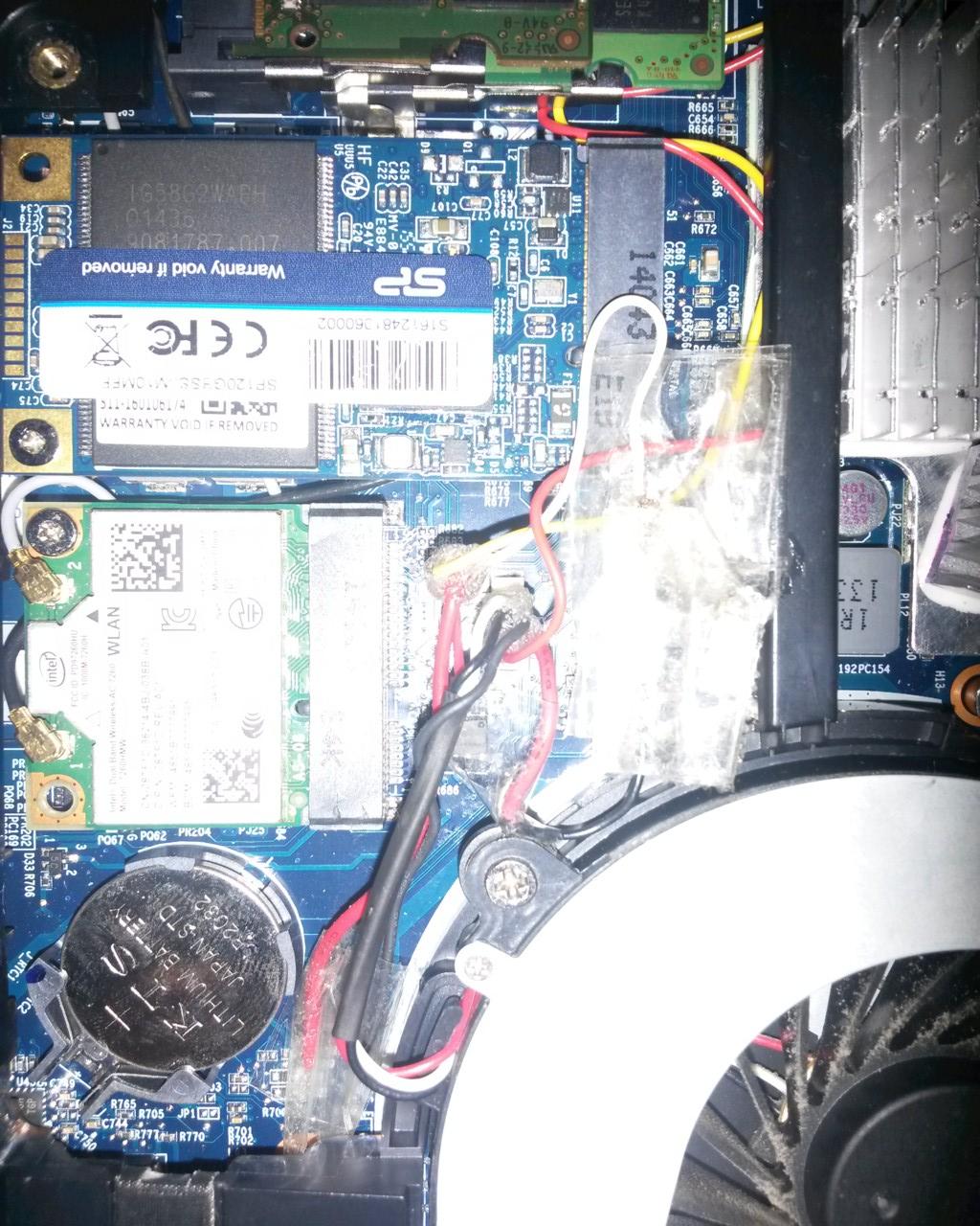

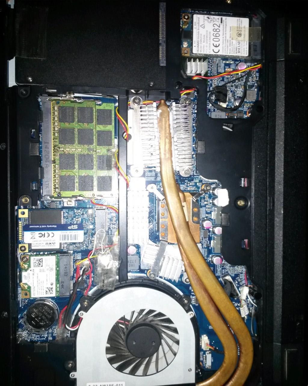

in case of the w230ss the build in fan has 3-cables to connect to the mainboard i cut the red or maybe the black cable put behind the twice ends the led or resistor so that power they given from the mainboard and the fan tours slower - figured out the right polarität with an extra cutted usb cable with the build out fan.
0k for me it eas try and fail with dameged led and or resistor maybe ? maybe must try and fail not done by the knowledge of the using komponents?
same knowledge sure helps to find right komponents led or resistor for the right trop down of power useage from fan (cpu rpm)

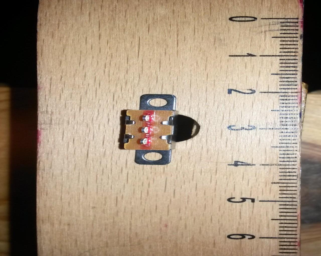

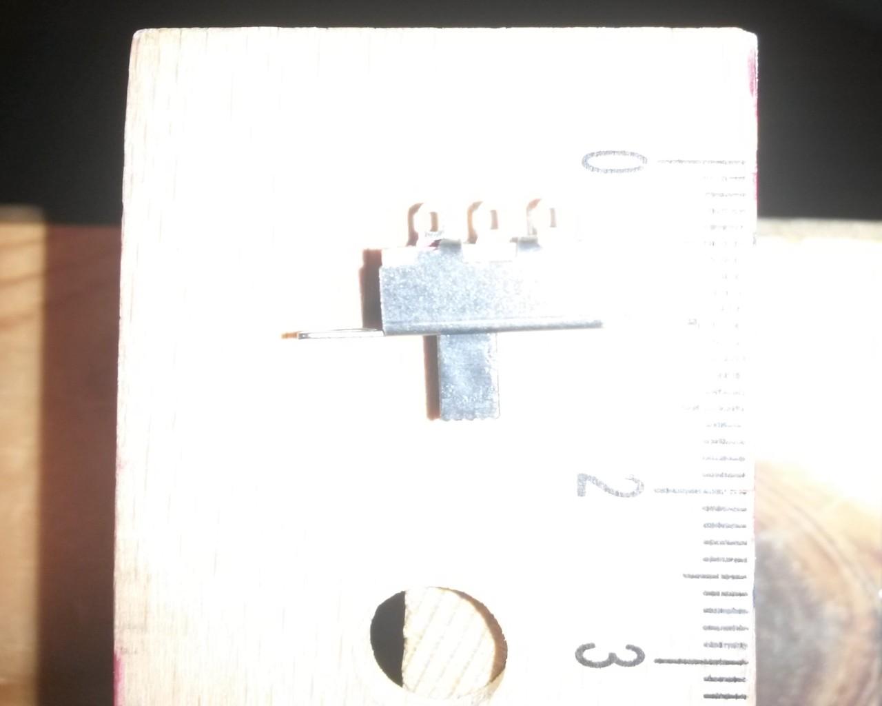

next part are the switcher that makes posible give the fan again full power from mainboard . ( had cut the length so fits better by handle w230ss by all day use)
the switcher have two states on & off but with three contacts with position of two contacts are given for enabled power so when man give the mainboard plug an extra cable thats go again direct before the upper cut of cutted cable to seen started from fan and but beside with uncuted red or maybe black cable to two contacts from the switcher its possible to do two differnt lines of power for all the fans.
