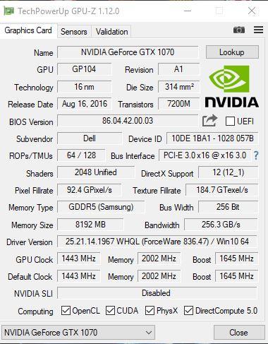

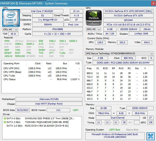

I believe the issue I have is GPU Throttling. The GFX card is recognised OK in BIOS, even if I run hwinfo or GPUZ then I can see the card recognised with my modified inf file.

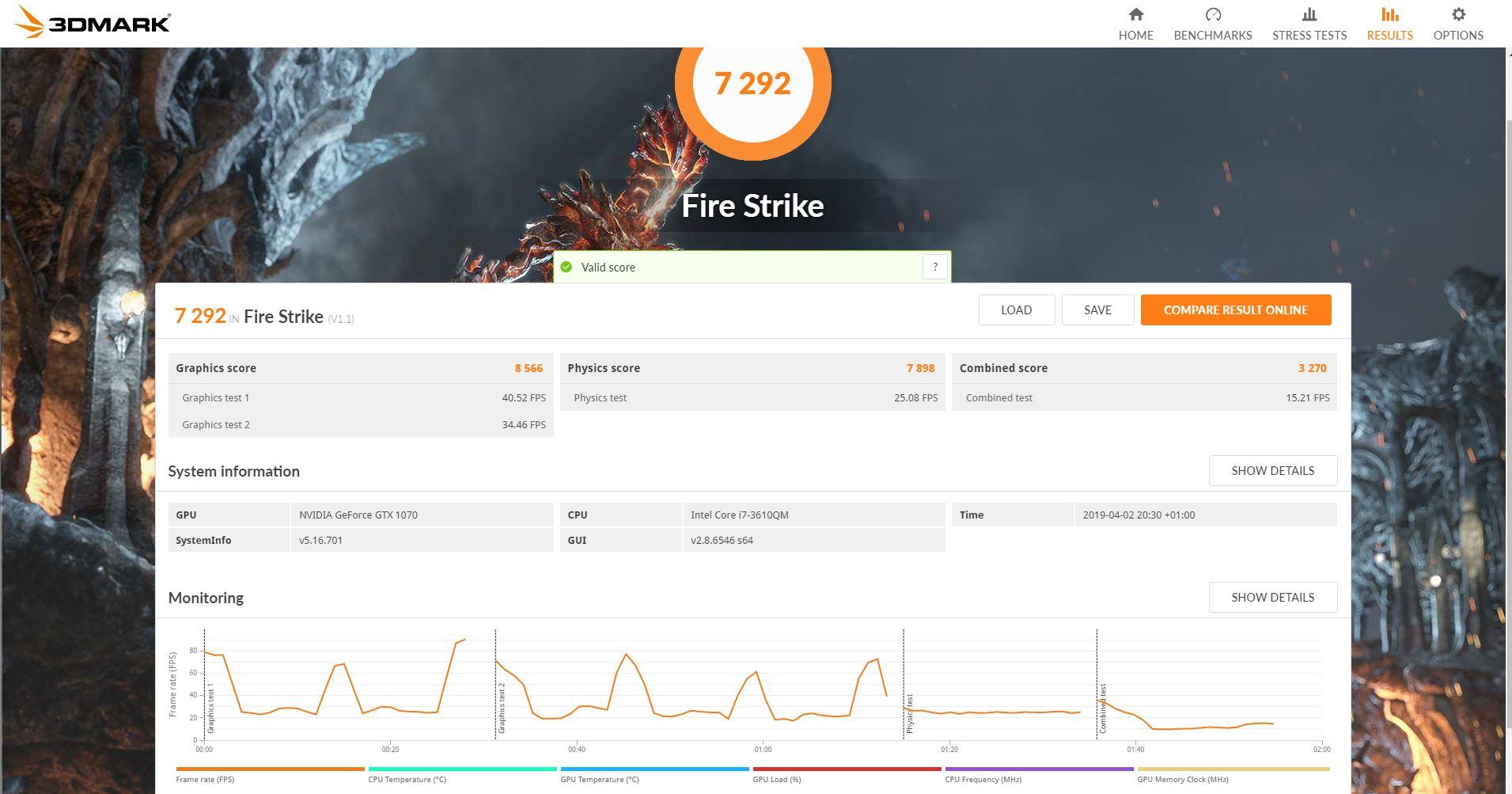

The problem I have is my 3d mark score is around 7200.
If someone is able to help me resolve this issue or point me in the direction where the issue may lay I would be very grateful.
Please let me know what information you would need to help me resolve this issue.3dmark.thumb.JPG.1b55f4e08d0a9b90e128f27d201affe4.JPG

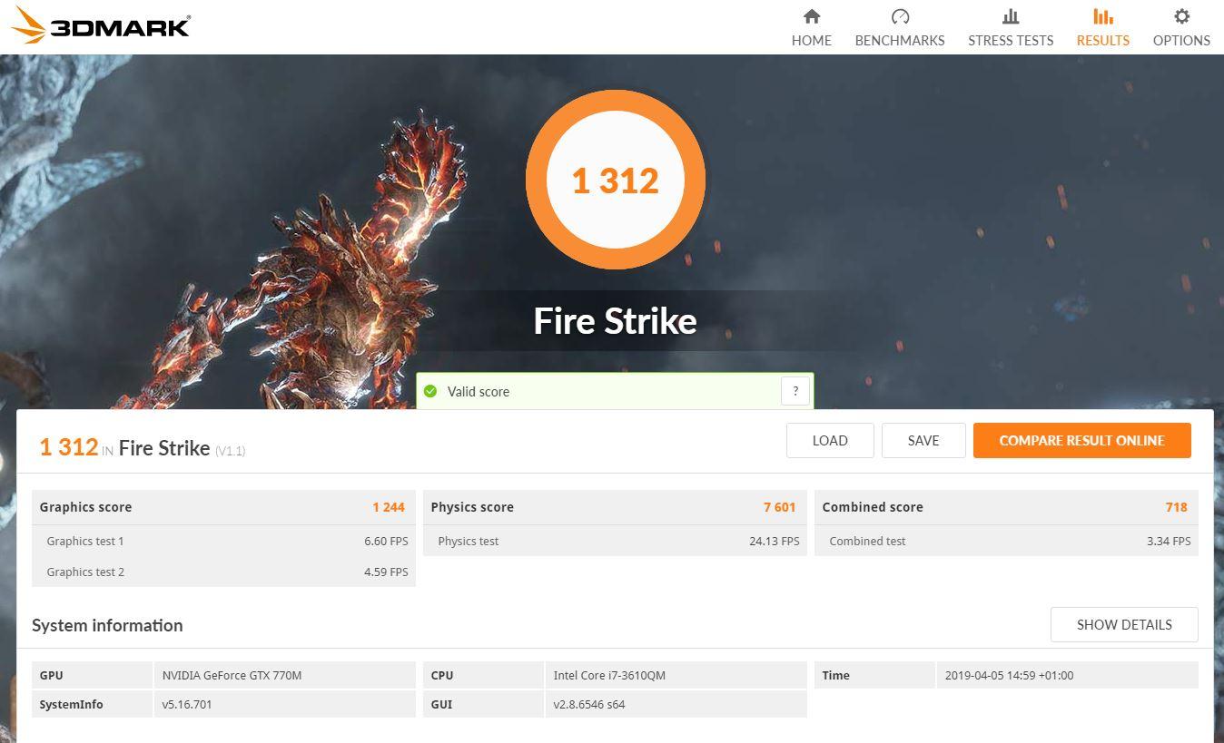

So I put my 770M back into the laptop & ran the same 3d mark test & got the following result:
At this point as Im really not sure what can be causing this.  If anyone reads this & has any ideas please let me know.
