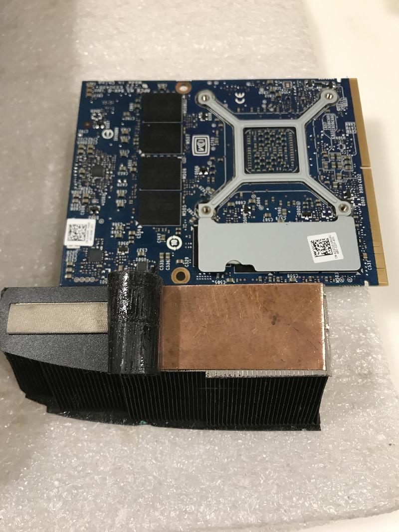

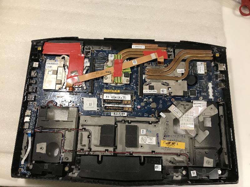

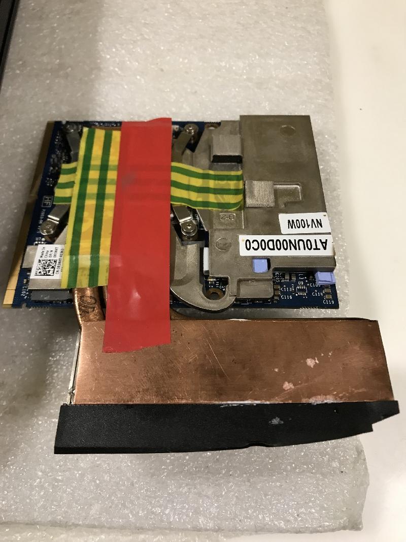

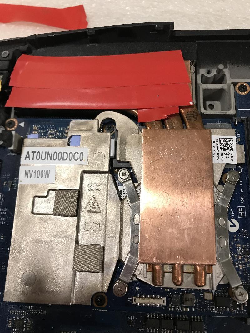

i started do my alienware and temperatures are reduced by a few degrees c
tested
cpu 4930xm 2x 880m
project in the testing phase
i do similar mod in alienware m17x r2 but i used silver plate 925 and was ok
on

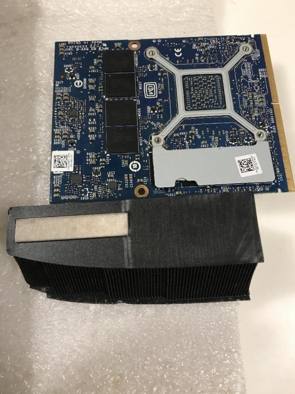

on the top should be aluminium tape i ordered and waiting
its 4-5 C different than Heatsink no 1 with no mod
and 3-4c  with other card  heatsing no 2 with no mod
with silver plate 925 different is -2C-3C   tested in alienware m17x r2 but silver plate its now expensive around 35-40 pound for plate 25cmx10cm

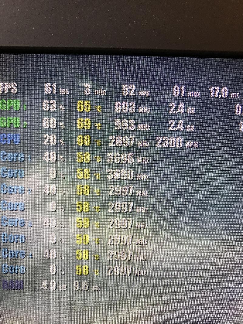

  • 1 year later...
i used for today now i changed to 1060m and only max 68-70c with this mod
i checked  second  heat sing  without mod 76-80c
on the cpu its best used thermal grizzly liquid metal
