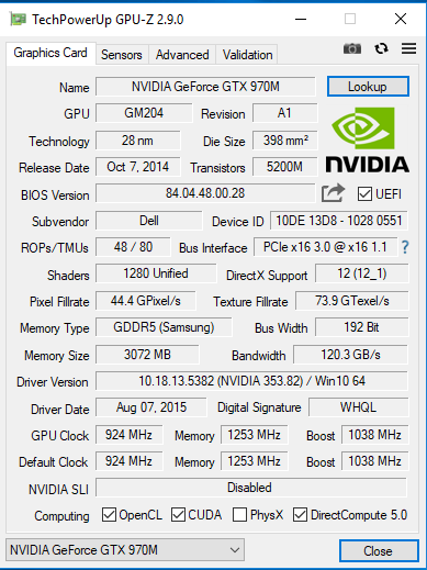

Hi guys, im having problem with 970m on my m17x r4:
Nvidia 970m taked from msi gt72 (vBios dont changed), M17x R4 with a11 unlocked BIOS and Windows 10. Laptop see 970m in BIOS and in Windows, drivers installed (nvidia control panel selected 970m as priority graphic), but 970m dont work - laptop not switch from hd4000, if i disable hd4000 in device manager, screen go black and get back with low resolution and low fps(felt as 30fps) and working 970m (tested with furmark). Changing in bios to PEG - get 8 beeps, working only on SG. So what i should do to make work 970m without disable hd4000(and problems with that)?

Post here your screenshot in GPU-Z.
