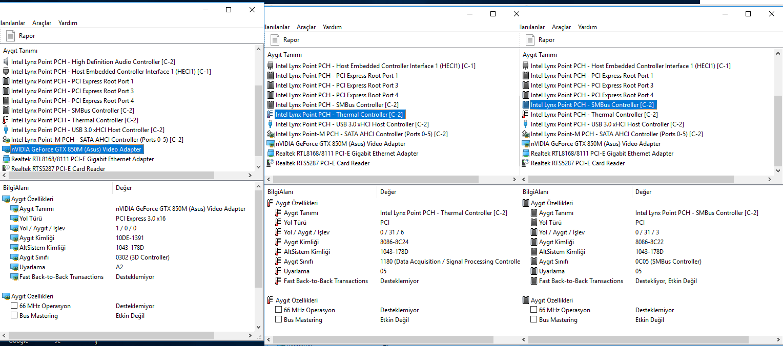

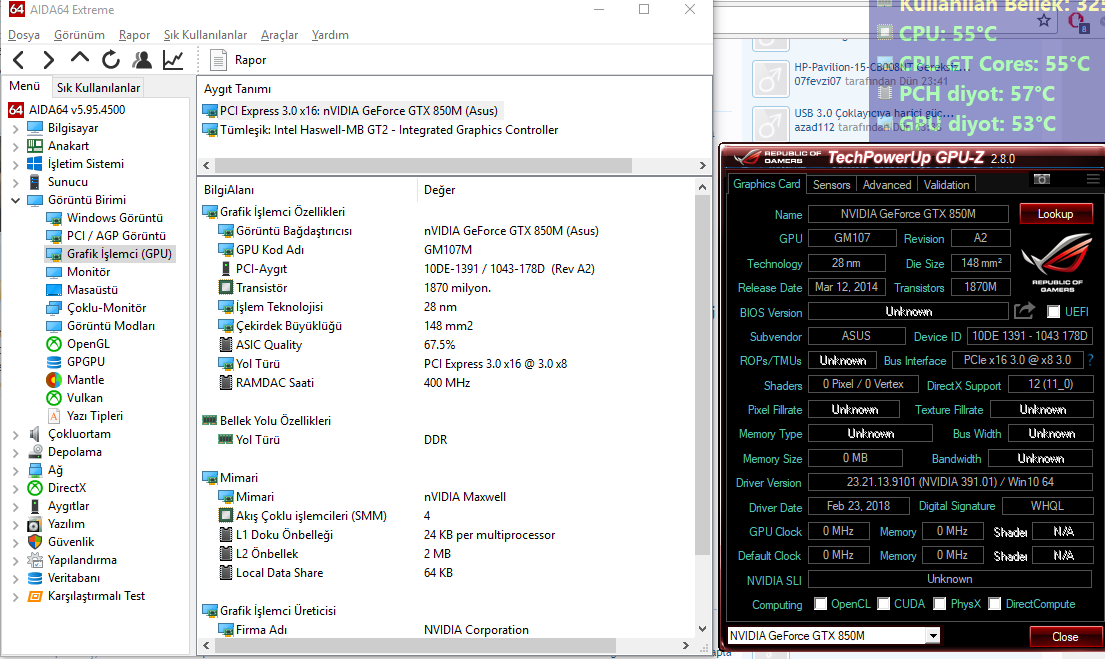

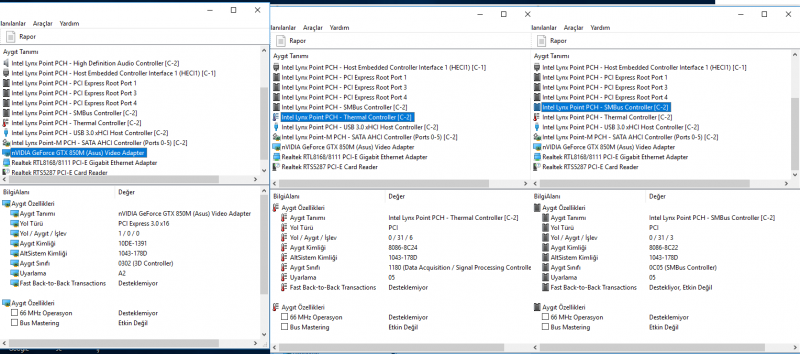

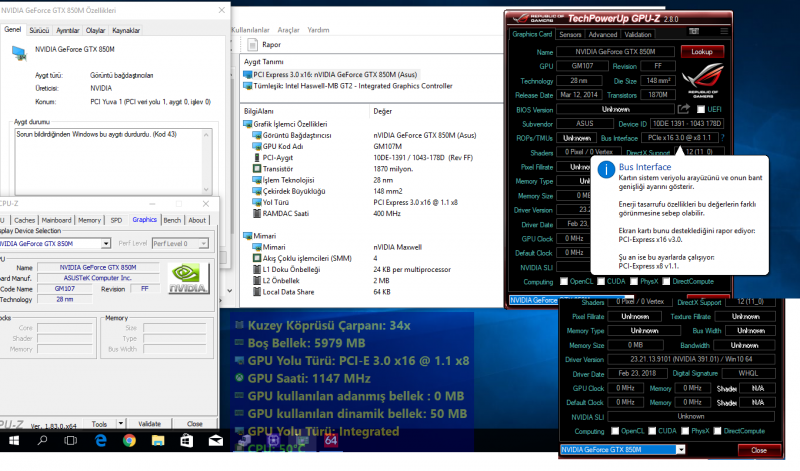

Hi. I'm sorry for my bad english. I write from the translator because it is not my original language. I started to get this error from the video card as a result of the computer crash. As a result of long searches, I could not reach VBIOS. I would like your GTX 850M DDR3 2048MB version of VBIOS. Thank you for your support.
Edit:Sometimes these visual values come up.

Hello!
In your case just download and flash the latest original main system bios  from Asus website.  Then reboot laptop, go in bios setup menu, and on the last page "Save and Exit" set "Default Settings", then press F10 to save, then Enter.
Then try to do next steps:
1. Completely uninstall MSI Afterburner with all settings. Reboot laptop.
2. Download the program DDU (NVIDIA drivers uninstaller). Run it and completely uninstall all NVIDIA drivers.
3. Download and install NVIDIA drivers with option "Clean Install". Reboot laptop.
