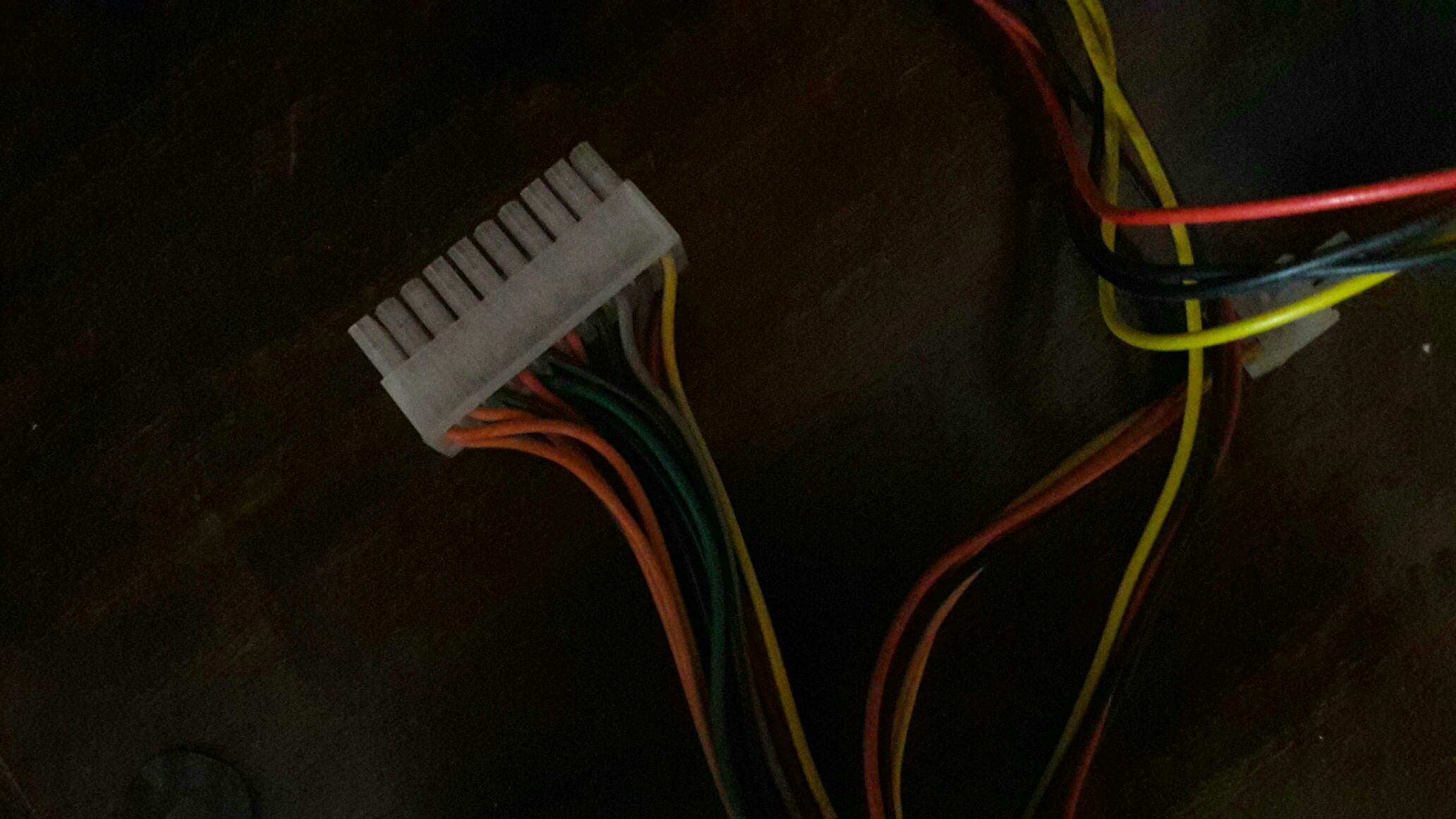

chesterhalo Posted May 9, 2017 Share Posted May 9, 2017 Hi. I would start investigating why is PSU not working. How can you tell if it's working? If you have everything wired right and laptop running, there is a green diod on GDC (at least on mine). You could also post the full spec, including eGPU and PSU. Why i said that psu was not working was because the fan did not start, even though I grounded psu and gave all connections properly I will post pics for your reference. In the pic If you zoom in you will be able to see a green wire(pin 15) and black wire for grounding(pin 13 or 14). When you do that the psu starts working. Please message me if the pic was not clear.Sent from my SM-J700F using Tapatalk Quote Link to comment Share on other sites More sharing options...
Deffington Posted May 9, 2017 Author Share Posted May 9, 2017 2 minutes ago, chesterhalo said: Why i said that psu was not working was because the fan did not start, even though I grounded psu and gave all connections properly I will post pics for your reference. In the pic If you zoom in you will be able to see a green wire(pin 15) and black wire for grounding(pin 13 or 14). When you do that the psu starts working. Please message me if the pic was not clear. Well, my PSU fan only works when it's under heavy load, which is never with just eGPU. I have only done this wiring once, which makes me no expert on troubleshooting. I would say that you should verify if your components work before any other action. Maybe you can use some other PC or PC maintenance shop to have your components checked. 1 Quote Link to comment Share on other sites More sharing options...
