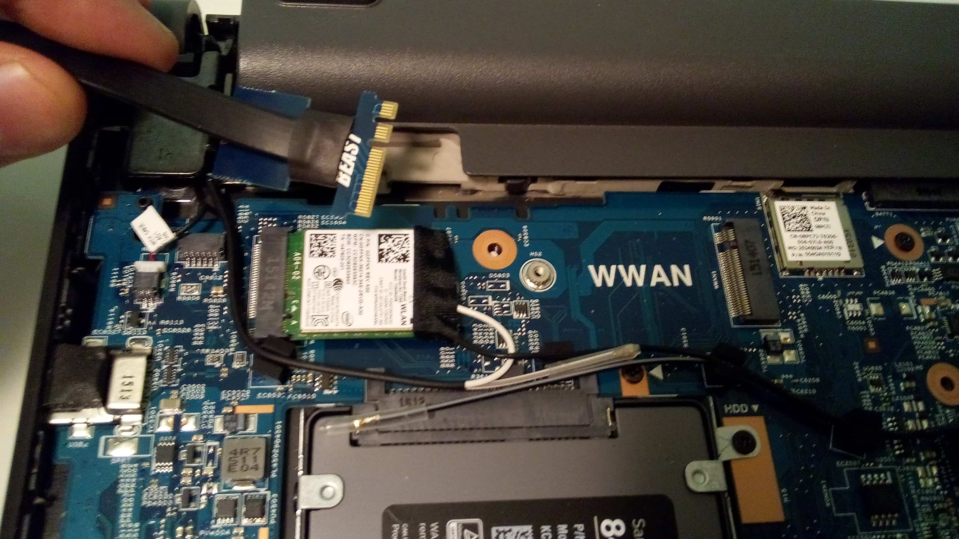

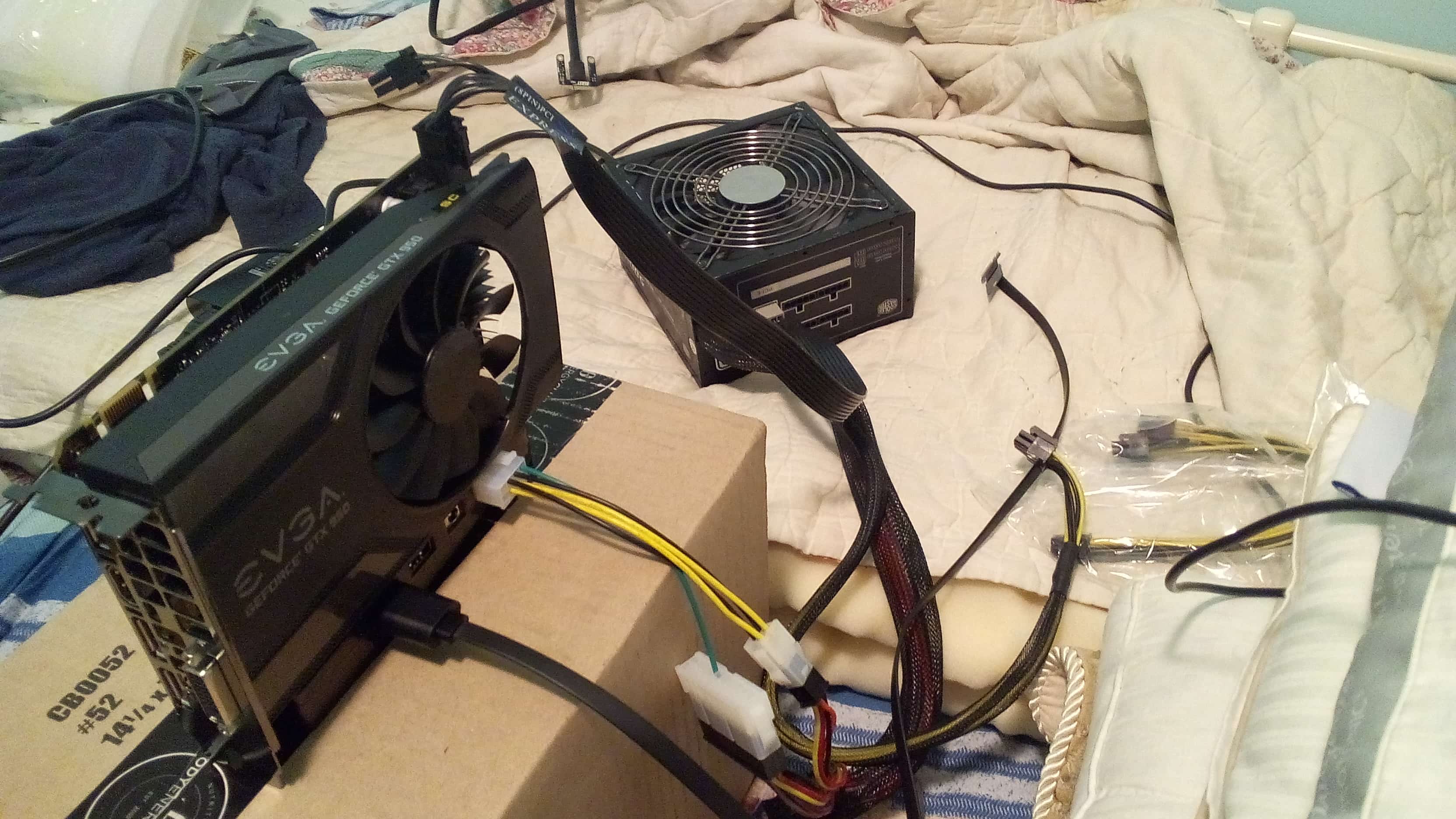

egpumaybe1 Posted March 9, 2017 Share Posted March 9, 2017 (edited) My gdc beast v8 just came in but my laptop won't power it on. I've got this: 500W coolermaster silent pro evga gtx 950 sc dell 3340 laptop with 250GB ssd and 8GB ram windows 10 home ngff connector from beast replacing wifi card I've proven the power supply and graphics card work in another pc. I tried looking for an obvious bios solution but can't see one. I can't disable any internal graphics. If I try to install the driver it says no card recognized. I also tried switching the small ATX power switch on the gdc beast to on. As well as the delay switch, 7s and 15s but no dice. That's just a pic of the ngff connector I replace the wifi card with. Edited March 9, 2017 by egpumaybe1 Link to comment Share on other sites More sharing options...
Another Tech Inferno Fan Posted April 14, 2017 Share Posted April 14, 2017 Use the CPU 4-pin connector, not the ATX 4-pin. 1 Link to comment Share on other sites More sharing options...
