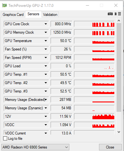

in my bios settings i changed it to gen2 but im not sure my EXP GDC V8.0 does even support gen 2... my average fps is like 90-100 on very low settings..
when u say "can you check gpu load while runing it" i belive u ask me to take a screenshot of GPU-Z while CSGO running.. so here:
4 hours ago, AdarC said:
If that's while playing csgo your  egpu is not being used.
Did you check if there is any AMD graphics switching option that's selecting the integrated graphics for the game? I have no other Idea for that right now...
i also think like that! the diffrence in Rocketleauge was su big. 6 times better fps, and in csgo the fps is almost same thing without the egpu...
