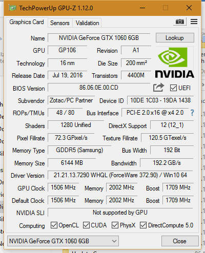

in my case it was a driver Problem. I can not use the eGPU with the newest Drivers. (373.06)
i use the driver 372.70, with this my setup works without errors.

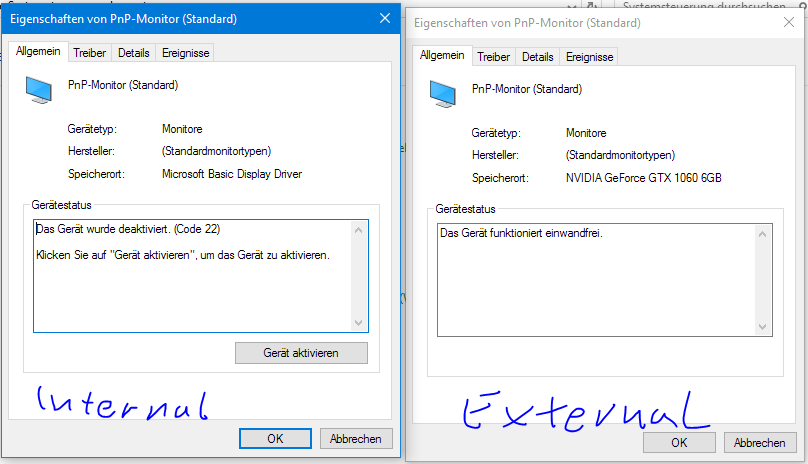

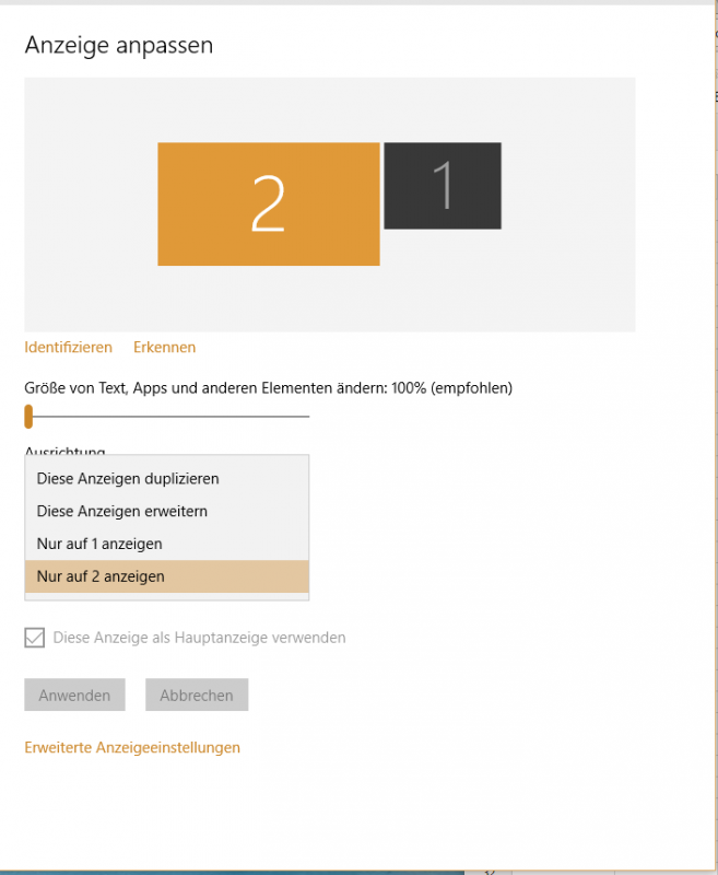

1. Disable dGPU in the Device Manager
2. Disable the Internel Display (Set you external Monitor to Primary and set the internal Display to not use)
3. reboot
4. Install youre Driver
If you have any issues let me known

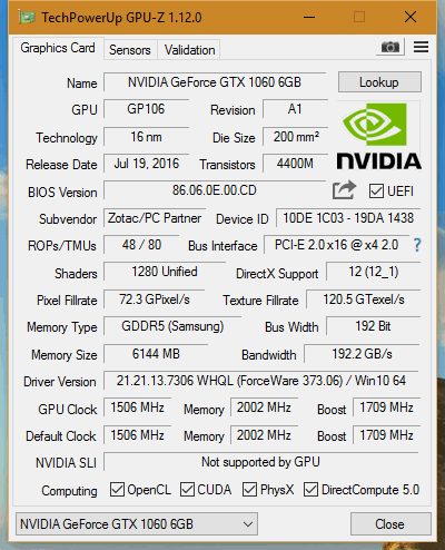

tested Drivers:
AMD Internal nVidia external Result
soft disable off 375.47 on OK
soft disable off 372.70 on OK
soft disable off 372.54 on OK
soft disable off 368.81 on OK
soft disable off 372.90 on OK
soft disable off 373.06 on OK
soft disable on 372.90 on Code 43
soft disable on 373.06 on Code 43
11.511.008 on 372.90 on Code 43
11.511.008 on 373.06 on Code 43

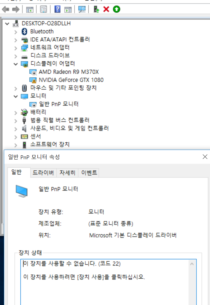

Thank you for your guide for EGPU!
I have almost same system like you which is, 15'MBPR sierra m370X + gtx1080 with AKITIO / WIN10
After finalizing the hardware thing, I had problem like you; the error code 43!
With your advice, I installed version 372.70. and....
Another error! error code 12 which says 'there is no resource to activate this Graphic card'.
So I disabled the M370X and it works with my second monitor!

Hello my friend i have good news for you :)
I`ve got installed the actual Driver 373.06, i hope this work around helps you too get the same result.

1. Disable the dGPU over the device manager (right click on the device -> deactivate)
2. Disable the internal display ()
3. reboot
4. install the newest driver in expert mode
5. reboot (maybe you get 2 - 3 times a black screen)
6. then check in the device manager for errors
(Optional) activate dGpu and the internal display
! if you boot with disabled dGpu and disabled internal Monitor, maybe you get a freezed boot screen on the internal display.
If this will not work for you boot in safe mode and revert the driver. I have some changes in the last days on my systems maybe the issue is some one else, but now it works for me i hope for you too.

All of the sudden, My egpu got problem, I formatted the win 10 and re-installed the windows 10 and updated to latest version of windows 10(1607 build).
And I deleted all of intel,nvidia, amd drivers with DDU. And then installed 370 version which is not latest version. This method was solution for error code 43 but after I installed this driver, still error code 43 is on.
I think I have to do the things you have done before. so, I wonder how to disable internal display and set external display as first display? I cannot use external display because my egpu is not working. (external monitor is connected on the VGA)
Can you explain more detail?

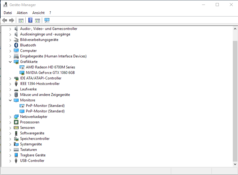

Make sure you have installed the boot camp drivers and the latest intel Chipset driver.
https://downloadcenter.intel.com/de/download/24345/Intel-Driver-Update-Utility <-- Intel Driver Update utility
From a clean System, eGPU should connected to a External Display
1. Update Windows
2. Install all drivers (Allmost bootcamp)
3. Update Intel Drivers
4. set windows to the Default Boot Partition (use the apple utility)
4. Shutdown
5. Connect eGPU
6. Power Up eGPU
7. Power Up you macBook (eGPU should 2 or more seconds run before)
8. Install the nVidia Driver 372.70
9. Reboot
10. Disable dGPU (in device Manger)
11. Disable Internal Display (in device Manager)
12. Reboot
13. Install the Latest nVidia Driver
14. Reboot
After this you can enable the the internal display and should be work.
in few days i can complete show you my setup (how is it connected and so on)
Edited by victorios
missing think
Was youre eGPU working after step 8?
You must get sure the eGPU will work before you disable the internal display.
Youre eGPU has on the Picture a indication. Wich Code Report there?
if its 43
- check youre PSU connection the Akatio and the GPU should be powered from the same PSU.
- remove the nVidia drivers with DDU and reinstall the 320.70 Driver
- check the code
if this not work check the chipset drivers, the code 43 is always a driver issue and reports the GPU has stopped. This is not a hardware, error or some similar.
Here the nVidia error code table https://docs.nvidia.com/deploy/xid-errors/
You can also try to install the Drivers only over the Windows Update.
another try is, use Refind (http://www.rodsbooks.com/refind) as Bootmanager with enabled "spoof_osx_version" to remove some apple restrictions for other OS.
