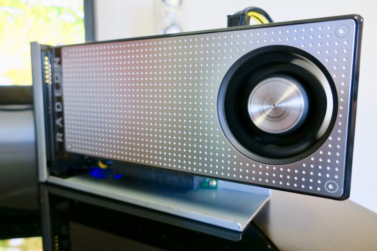

Last but not least you need a powerful graphic card. I’m using an AMD Radeon RX 470 graphic card which is part of AMD’s newest Polaris lineup. I chose this GPU because of its 150W TDP power requirement. There’s no official driver support in Mac OS X. However, macOS Sierra 10.12 has drivers which can be modified to make use of the RX 470.
Thunderbolt eGPU for Mac
Thunderbolt eGPU for Mac – AKiTio Thunder2 Enclosure + AMD Radeon RX 470 GPU + Dell DA-2 220W Power Supply

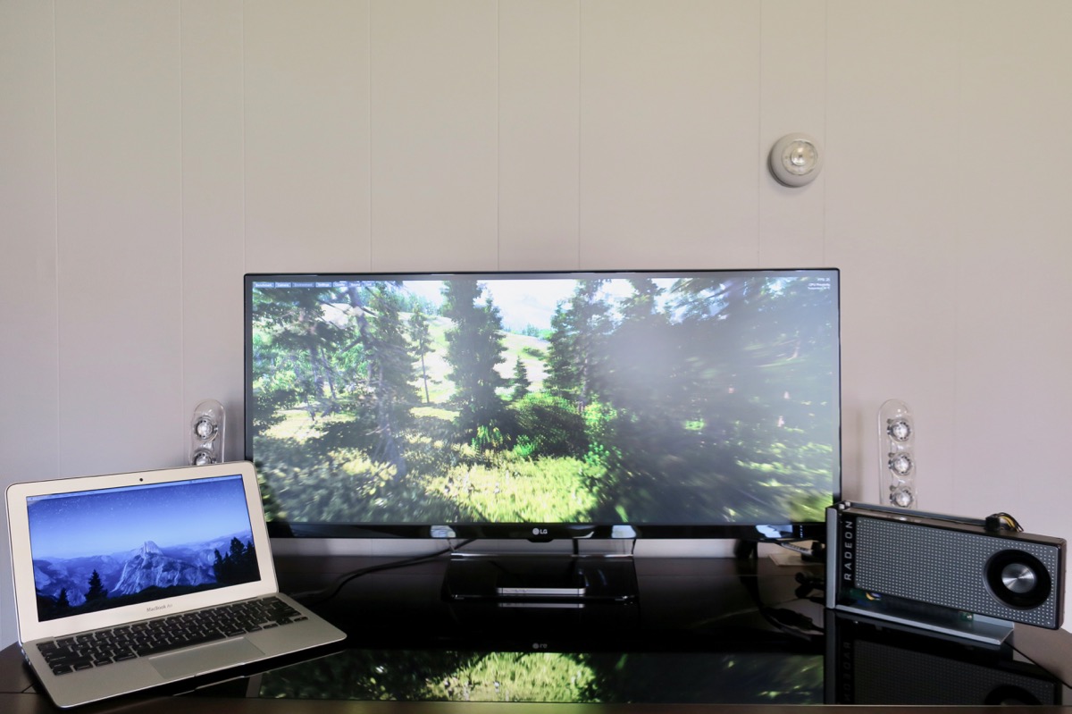

Similar to most external peripherals, the eGPU has a few connections out the back. I modified the Dell DA-2 to have a barrel plug to power the AKiTiO Thunderbolt/PCIe board and to have a PCIe 6-pin power cable to power the RX 470. The AKiTiO enclosure communicates to a Mac through a thunderbolt cable. A DisplayPort cable connects the graphic card to an external display.
I’m using a MacBook Air 11″ to demonstrate the performance gain this eGPU provides. All current Macs could use the performance boost from a Thunderbolt eGPU except the tower Mac Pro which has PCIe ports and can use newer graphic cards internally.
RX 470 eGPU with MacBook Air 11" and LG 34" Ultrawide screen
RX 470 Thunderbolt eGPU with MacBook Air 11″ and LG 34″ Ultrawide screen

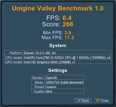

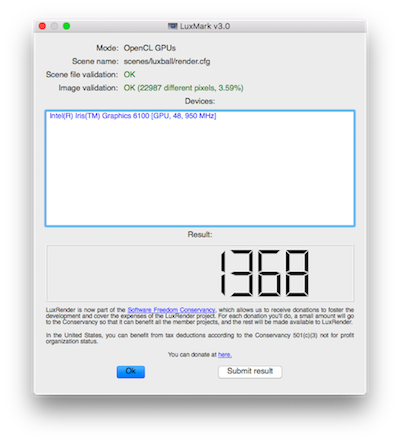

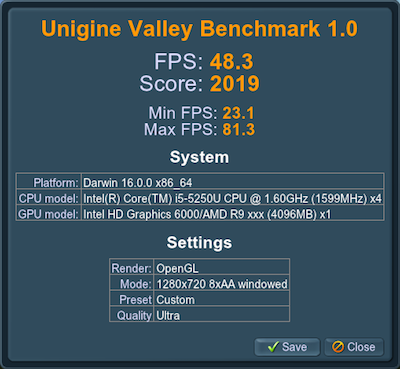

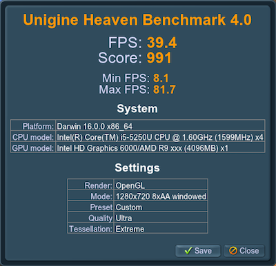

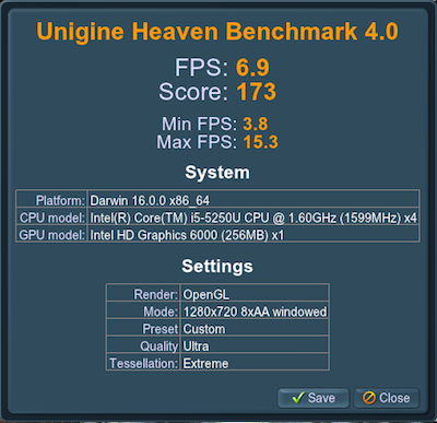

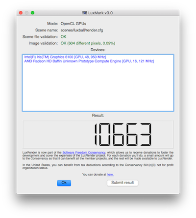

The improvement is significant. These benchmark scores show the Radeon 470 Thunderbolt eGPU performs 8x faster than the Intel HD 6000 integrated graphic card in the 2015 MacBook Air 11″.
Intel HD 6000 Luxmark benchmark score  RX 470 Luxmark benchmark score
Intel HD 6000 Unigine Valley benchmark score  RX 470 Unigine Valley benchmark score
Intel HD 6000 Unigine Heaven benchmark score  RX 470 Unigine Heaven benchmark score
As excited as I am to see these scores, building a Thunderbolt eGPU is only a stopgap. Many professionals who use Macs for their daily work are finding it harder to stay within the ecosystem as the graphical computing performance is not meeting their needs. At the end of the day, Apple needs to step up its Mac game to rekindle the enthusiasm of its most loyal users.
